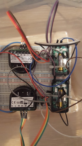

I have done this with my blinds with Build-In-Geiger-Drives (see https://community.zipato.com/topic/support-for-tedsen-or-geiger-drives-433-mhz-and-workaround ) It works fine (see picture). However, this is not a cheap solution.e3d3dfbee515f121ebf8454d35082398
I use a similar work-around to exchange some signals between 2 independent Z-wave controllers without http-request (http would depend on internet and zipato does not support https).
