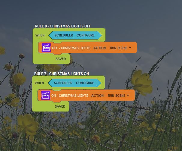

I have a rule that turns on my Christmas lights at sunset and then turns them off at midnight. Right now it's two separate rules. Is there a way to combine these?
It works just fine, but I'm trying to learn a little more about the rules.
You could try with an "OR"
But better is to make 1 rule with the sunset/sunrise that triggers a virtual switch. Then you can use this switch in one rule.

A switch is just like a boolean variable (on/off = true/false). I use a lot of them to control many rules, for example:
- Working day switch (is today a working day?)
- Cloudy day switch (is it cloudy?)
- Daytime switch
- Autumn/winter switch
etc etc. You set up a rule to set the value, and then you can use the value in many other rules. In a way it's a substitute for the ability to define subroutines.
