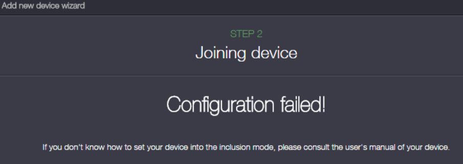

Configuration failed directly when trying to add 433 device
Roger Wiberg shared this problem 10 years ago
I have encountered an major problem
When I try to add som NEXA LMDT-609 devices my Zipato has gotten some error.
As soon as I press the device and synchronizing starts it take 1-2 seconds and I get the attached error.
I have tried to reboot the box but without any luck,
What to do?

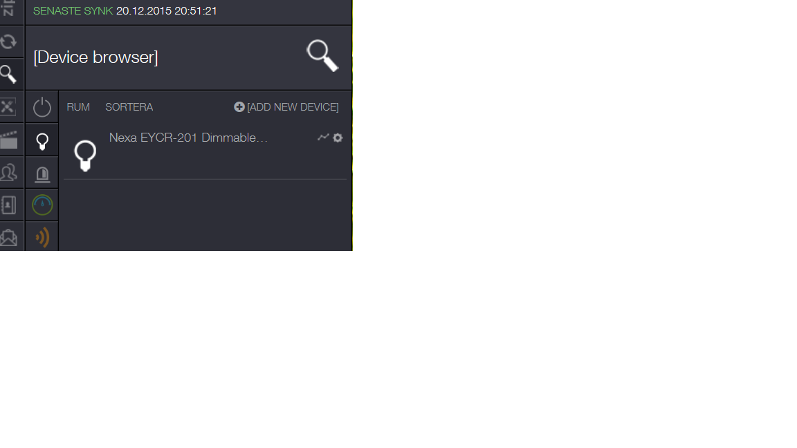

Yes i did the latest firmware. I get the icon in the device browser. But it has no on off switch or slider for light power 0 -100 %

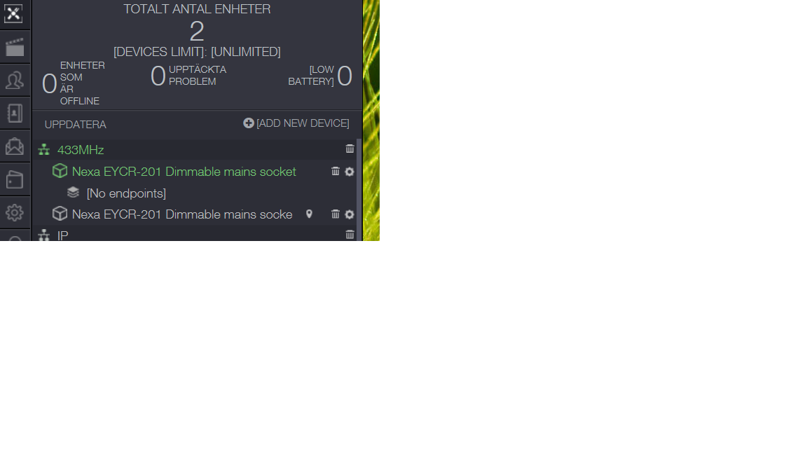

The icon is NOt complete Slider is missing. If i click on the icon nothing happens.
Works fine with learning to my Telstick so the unit works fine.
Well, this is something else. I will have to check this tomorrow in my office.
You can try to select "show as device" on cluster level if it is on endpoint level and vice versa in the settings. You have to refresh and sync after that.
