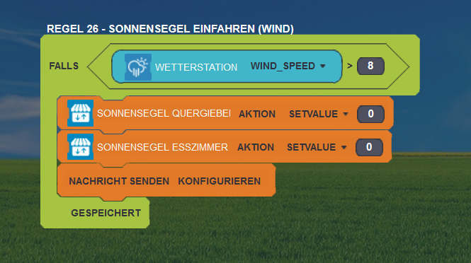

I have a issue to control my Somfy RTS device. I have two devices added. I can control them when I execute them directly. Within a rule it don't works.
I use the standard and set value to e.g. 0 or 100
or should I use another parameter?
RTS 433 Mhz is unidirectional I know, so I am note sure which is the right one
Use gotovalue. That works here.
