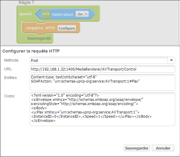

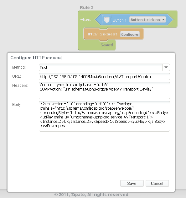

I didn't succeed. I copied the "play" example, I only changed the IP address for the sonos. I then turned on the virtual switch, nothing happens...
The IP address is correct because I can reach the sonos with the command "http://192.168.1.32:1400/status"

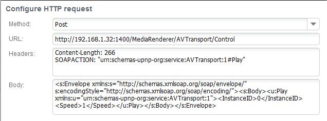

It finally worked with the command in the attached image...

It plays with the example I put above, at least for me.

Tried the Sonos device in Zipabox but that made the 433 Mhz stop working so for now I'm trying to get the samples above to work.
But no matter what I do I don't seem to work, I've tried it with different Sonos units (Play x, Connect x) but no luck. So before I keep trying I wanted to check if I've done something wrong or if maybe the Sonos interface changed.
This is what I'm using (the IP no is OK):
Method:Post
URL: http://192.168.1.64:1400/MediaRenderer/AVTransport/Control
Headers: Content-type: text/xml;charset="utf-8" SOAPAction: "urn:schemas-upnp-org:service:AVTransport:1#Play"
Body:
<?xml version="1.0" encoding="utf-8"?><s:Envelope xmlns:s="http://schemas.xmlsoap.org/soap/envelope/" s:encodingStyle="http://schemas.xmlsoap.org/soap/encoding/"><s:Body><xmlns:u=Play xmlns:u="urn:schemas-upnp-org:service:AVTransport:1"><InstanceID>0</InstanceID>,<Speed>1</Speed></u:Play></s:Body></s:Envelope>
Method:Post
Body:

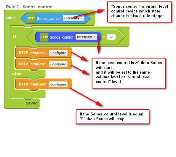

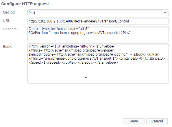

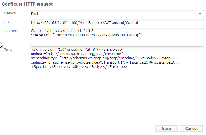

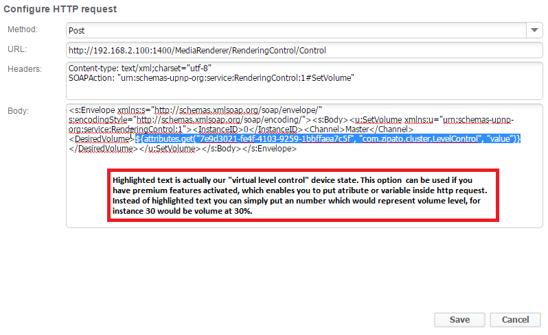

Hello Johan,
I have added some examples in the attachment.
Hrvoje
Hello Johan,
Hrvoje
