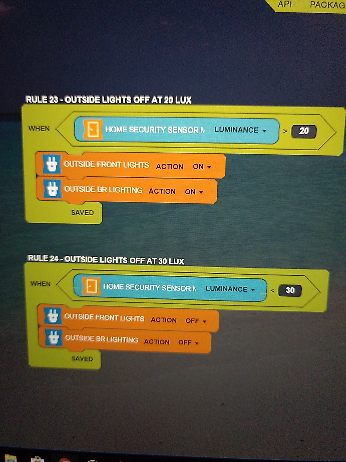

Is this correct? Is itsnt working for me.
I don't quite understand what you've done there, because it's turning the light *on* (even though it says "off") when the reading is above 20, but then off if it's below 30? I think the result will be the opposite of what you want. Better to simplify and follow the schema I suggested - one rule, triggered always whenever the lux value changes (anything from 0 upwards). Then specify the on/off conditions inside that single rule.

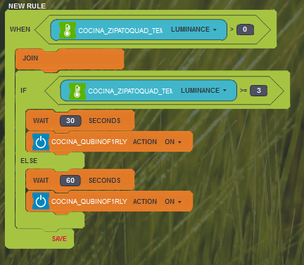

Liam,

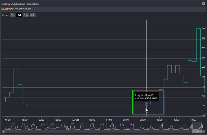

I would do something like the attached rule, Zipato Quad shows luminance values on % not LUX. JOIN puzzle is to make the rule restart (or be triggered again) in case the sensor updates values to Zipato controller. In my case 1-3 % is more or less sunrise/sunset window.
