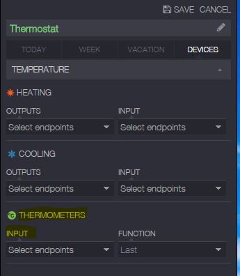

Hello I have a virtual thermostat with Danfoss living connect valve.
In the configuration of the thermostat the Danfoss valve is set as Heating outputs and nothing else is filled.
The thermostat report in red the heating endpoint and is also reporting the Current Temperature (as 22°).
From where is taken the Current Temperature?
Can I set the current temperature from a virtual thermometer?
thank you!
Dear Carlo,
Current temperature is taken from the Thermometers input. (Attachment)
Yes, you can set the current temperature on Virtual Thermostat from the Virtual Thermometer.
Pero Zovkic
Dear Carlo,
