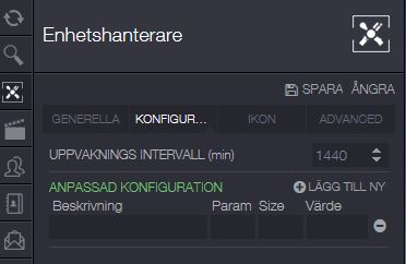

Configuration is in device manager on root level. There is a wrench icon. After clicking, second tab is configuration
I know but...
Still missing all the parameters mentioned in the manual.
Do I have to type them my self?
And in that case what goes where?
Description Param Size Value
PIR Sens 3 1 50
Looks like.device.descriptors are not yet created. Send a ticket to support. In the meantime.you can enable all parameters by manually inserting them.
The device I a rebranded philio sensor so zipato should be able to quickly enable decriptors for this device.
I have those in use for weeks without problems.....
Do you se all the parameters that is mentioned in the manual in your Settings\Configuration Tab?

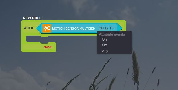

And how do you use the device in the rule creator?
I'm not able to choose any useful values on the motion detection, just On|Off|Any?

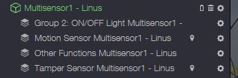

I have succeeded in associate Group 2 ON/OFF Light with a Switch and it works alright.
But the switch is a double switch and I'm only able to associate on device level, that seems to be Switch1 by default. Can you show me a rule that you have created on the device (motion, Temperature, Daylight level).
