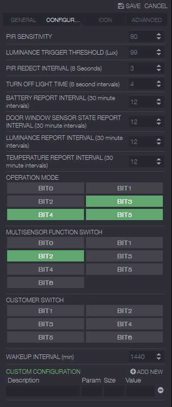

Have you check configuration on this devise.
5 Operation mode bit 2 set to 0
7 Custom function bit 3 set to 0
11 Report interval < 1
I think that is al configuration. I haven't this, so i can't test it.
This is the original configuration after including in my Zipabox.
I lowered the intervals afterwards but it changed nothing.
In webfrontend it says "Closed" but there is no data. In Zipato Android App there is no status shown.
If the sensor opens or closes there is a submission to zipabox. But Zipabox don't shows this. In Zipabox eventlog there is nothing.
