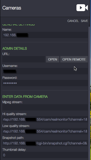

I also attach a snapshot from a working configuration of Dahua IPC-A35. This is a statically added camera, hence I had to fill in the Zipato fields afterwards. Notice that to fetch the video streams remotely through Zipato, you must strip the username:password from the URL's in Zipato UI, adding them to the Username/Password field. Zipato will add username:password to the local and proxy URLs it generates dynamically behind the scenes.
