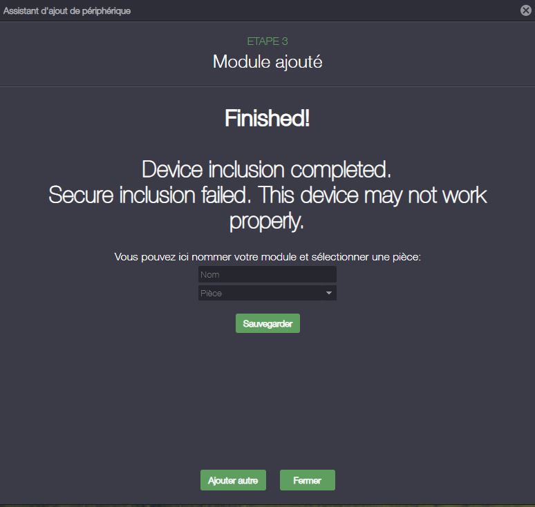

I just tried again, but like some month ago at the end of the inclusion I have a message saying that secured inclusion failed.
I see the lock in the list of my devices, but whatever I click on "Lock" or "Unlock" nothing happens...

Unfortunatly, still the same error message, and nothing happens when I click lock/unlock in Zipato web ui
You got the message "secure inclusion failed" right?
Yes, see capture
Yes thats the problem. In that case the danalock don't work.
Please change the location where you include the Danalock. If you were previously one meter left of the Zipabox, now try one meter right of the Zipabox. Sometimes another device interferes from the direction.
