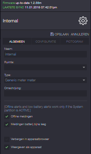

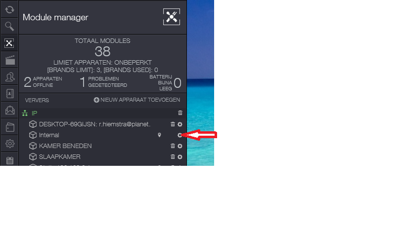

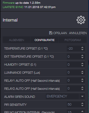

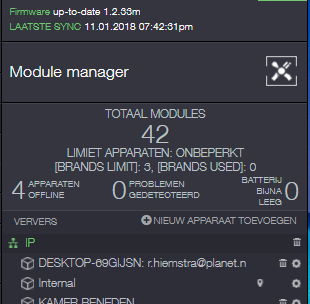

Hi Paul,
my question was about the internal temp sensor in the tile, but I guess it should not make a difference if its the internal or external temp sensor.
take a look at the attached files how it looks in my UI.
as you can see its the software version 1.2.33
regrds,
Roberto
Hi Paul,
regrds,
Roberto
I think those settings must be unique to the zipatile as there is nothing like that on the zipabox
this could well be, due to the fact that the Tile has an internal temp. measurement
