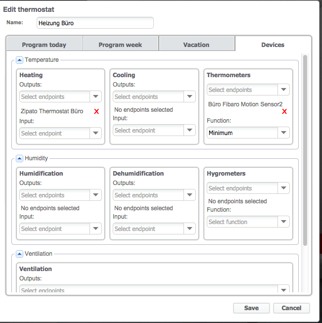

I´ve set Danfoss valve in the climate widget as Output Device in the heating tab. At thermometers Tab i`ve set the magic eye and added "minimum" as the value. Even if i don`t understand this value but even if i change it nothing really happens.

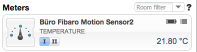

The Thermometer measured in the room at 21.8 celsius. see 2. screenshot.
Unfortunately at the climate widget the temperature is 23.2 celsius...at least this is what stated on top of the widget when looking at the climate zone.

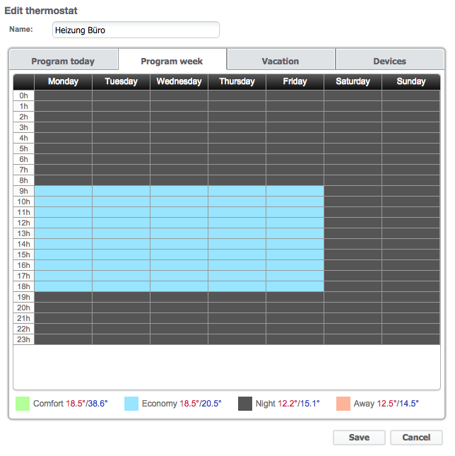

At edit thermostat i`ve changed the values to much less at it is per default. see another screenshot.
My thoughts are that this is the temperature i want to have in the the room. so for today i have the night program running an it is set to 12.2 celsius. so even if it is 21.8 celsius in the room, which is the value from the thermometer, the radiator is running is producing heat.
In my opinion the radiator should be totally cold as there is no need for heating because of more than 9 celsius over the set value.
Or did i just thing the wrong way?

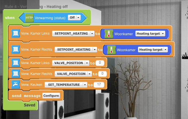

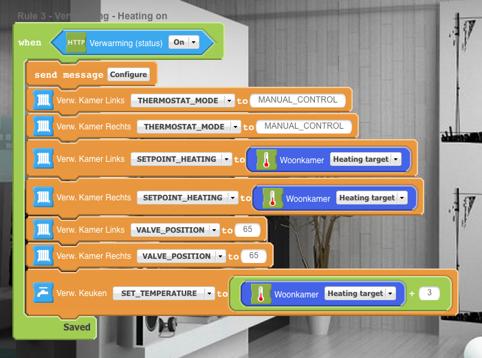

I made a workaround with two rules (heating on and heating off and a virtual switch).
The output of the climate widget is a virtual device witch triggers two rules.
By setting the SET_TEMPERATURE 3 degrees higher (last line in the rules) than the temperature set in the climate widget I now for sure that the valve starts heating.
When the desired temperature is reached in the climate widget turns the virtual device off witch triggers the rule heating off. The SET_TEMPERATURE of the valve is set 17 degrees.

However i tried to implement the rules you`ve sent as screenshot but i struggle somehow. I would like to raise a few more questions:
- I guess the valve_position is not a Danfoss parameter and therfor i don`t need it?
- what means the "http verwarming status" and how to add it?
So in summary if i understand your rule correctly you are not using a desired thermostat or is this the trigger from the climate widget?
