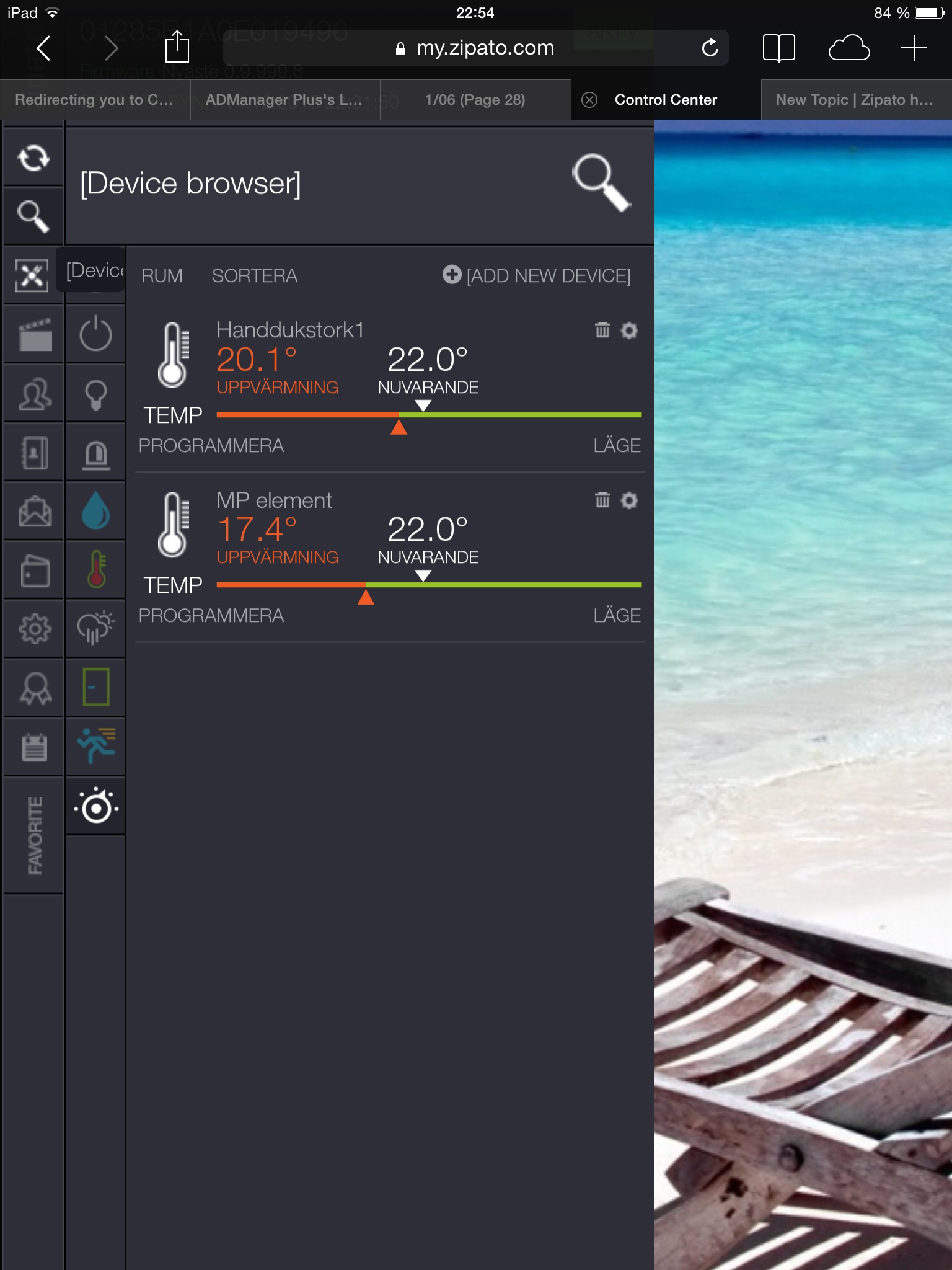

I own three Danfoss LC-13 radiator thermostats. Two of them works perfectly under Zipabox, including temperature schedules, but the third unit won't behave like the first two.

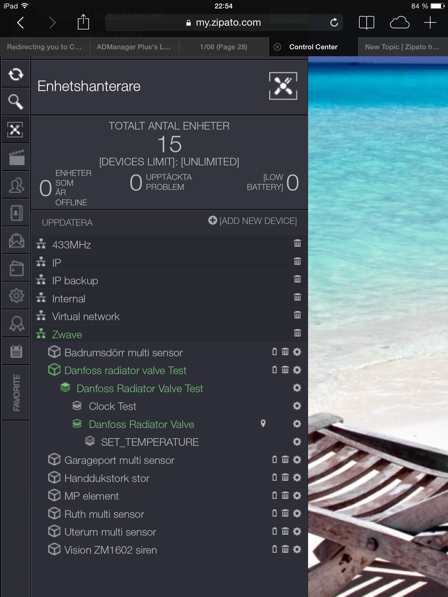

It's properly included in the Z-wave network and I can see it in the device browser, but only as temperature meter. No matter how hard I try I can't seem to get it to show up in "Thermostats" with the first two units, so planning temperature schedule is impossible. Please advise how to fix this.

Thank you! I had added and removed the valve from the ZB control panel over and over again, but a factory reset of the valve itself was needed. You truly deserve a merry Xmas for sharing the advice!
(To do this: Remove battery from valve, press and hold the o-button 5s while inserting battery, and the valve is fresh again.)
