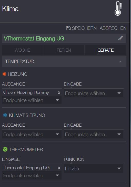

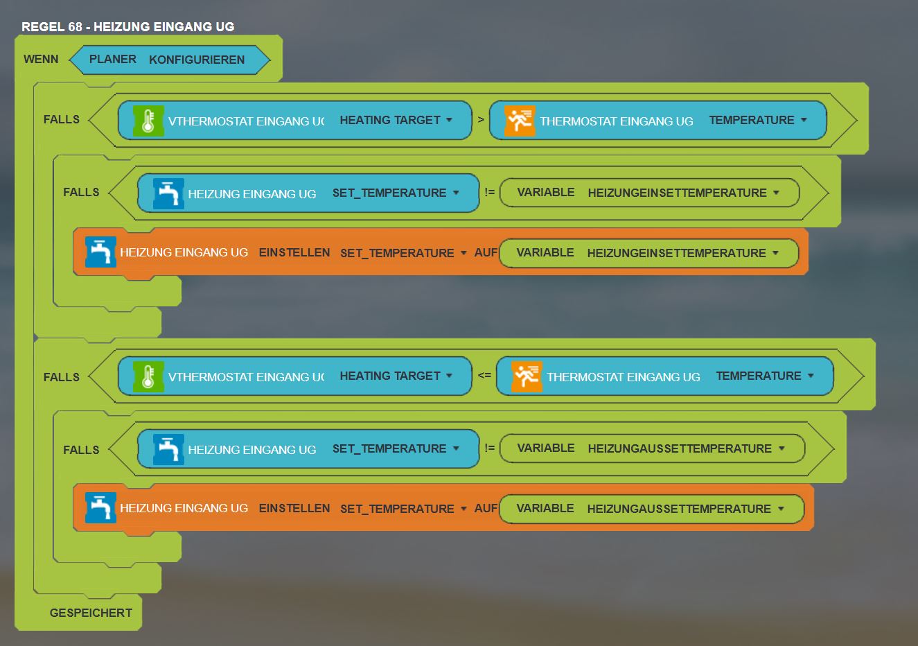

Hi Risto
I think you might have a look at your virtual thermostat configuration. Because if you add your danfoss valve in the virtual thermostat as target then it will overwrite your values automatically.
I use a virtual level meter as a dummy target for each virtual thermostat. Then I am able to set the temperature on the danfoss.
I hope this helps.
Beat
