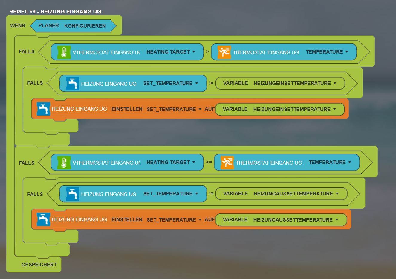

Yes I see your problem as I had a similar one...my solution was to create a rule for each virtual thermostat combined with an external temperatur sensor. Using the rule you will know exactly when the heating should be on in a room or off. This could then trigger your boiler to turn on or off.
I hope this makes sense to you?
Beat

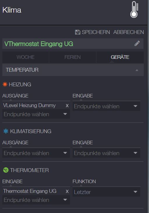

Christopher, sorry to insist, maybe it's a language issue from my side: have you configured a virtual thermostat? Have you followed steps on my link? Basically don't forget to add the trv into the output field!
Hello Christopher,
I believe you are missing the Valve into Output... See this post on how to configure the virtual thermostat, maybe it is helpful: https://community.zipato.com/topic/help-with-the-set-up-of-a-virtual-thermostat-with-2-radiators-valves. As you can see valves must me into the Ouput field for sure. Output is compulsory. Input is optional if you wish manual income on a certain valve is reflected and respected by the controller.
Regarding the reading of the temperature of the Danfoss, please check this post regarding multiroom heating and Danfoss valves: https://community.zipato.com/topic/honeywell-evohome-vs-danfosspopp-zwave-on-multiroom-heating. In this case you may need and additional device for temperature measurement.
Hope this helps!
