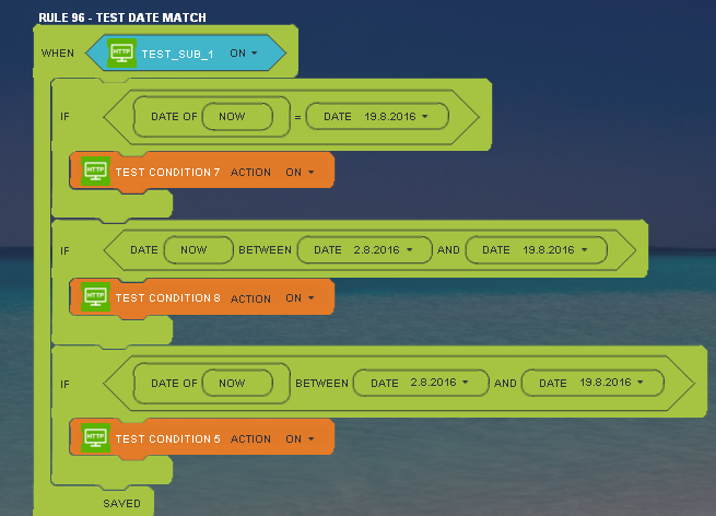

I've reported the following bug to Zipato. I'd be interested if anyone else has experienced this.
I've found that the standard way to compare with a range of dates doesn't work. If you use the (Date x between y and z) variable piece, the comparison fails. But if you use a standard between operator with (date of (now)) and two dates, it works. In the attached screenshot, you can see three tests, the last two being date range comparisons. Test condition 5 is set to "on", but test condition 8 is not. (Today is 19th August).

I have wasted some hours on this myself. See here for Zipatos explanation of the difference between time and time_of (last post in the thread)
https://community.zipato.com/topic/the-logics-of-set-to-truefalse
Not very user-friendly and impossible to know in the first place
I still don't understand the difference after reading the explanation, unless they mean that "time of" is used with a variable containing a time value...? That would be nice if it worked, but I tried to use it and gave up. Maybe I should give it another go.
In any case, both of the "between" options should work in the same way, surely?
This now seems to be working with 1.1.38.
