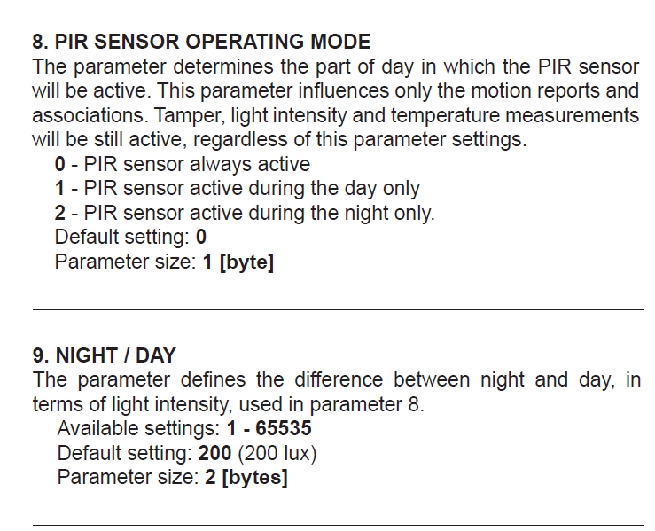

I have associate a motion sensor and a switch and it works fine, but I want to deactivate the motion sensor if the luminance are higher than X lux so the light don´t will go on. Is it possible to make a rule that solve that?
I have Fibaro Motion Sensor and Fibaro Wall plug.
Yes, it can be done. Fibaro motion sensor can be active only at night based on luminance, check the manual on parameter 8 and 9.

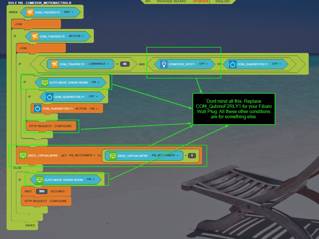

Also you can do it by rules, it a bit slower but works just fine. Is basically a IF ELSE puzzle inside a WHEN puzzle.
