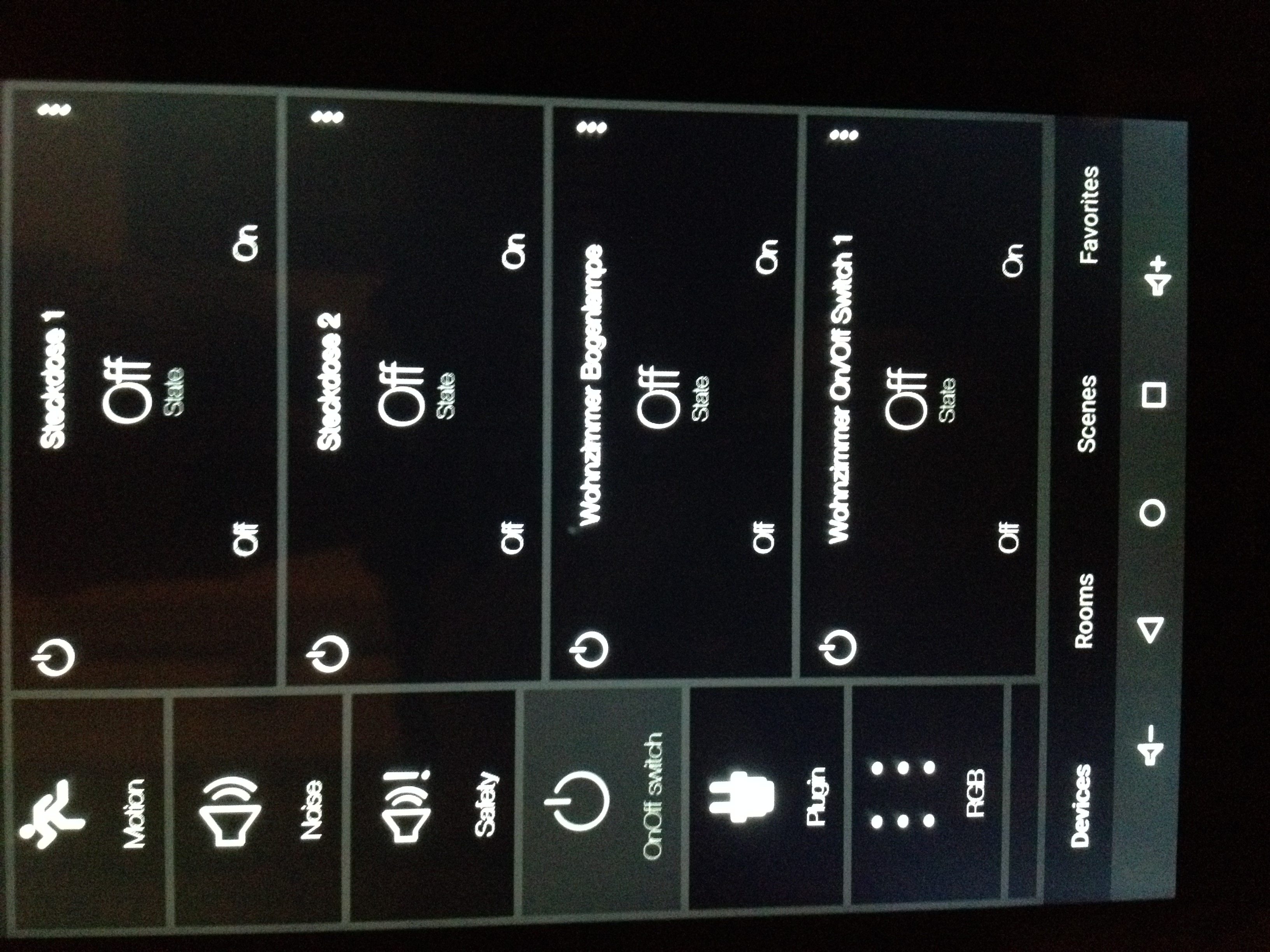

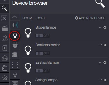

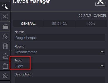

I have defined different z-wave devices in the device browser as a type "Light", see pictures.
In the web browser everthing is displayed correctly, but on the Zipatile dispite synchronizing and refresh the devices will be always displayed as an "OnOff switch". For all other devices where I switch the type it works fine on the zipatile.
It seems that there is a special problem only when the device type is a "Light", also in that case the name of the device will not be updated on the zipatile.

maybe the problem is that the luminance symbol on the ziptile will be display as a category light. On the web control center it will be displayed as type "luminance".
The picture on the zipatile shows diffferent devices than the picture of the control centre. Can you show me the device type for steckdose 1 and 2?
That is what I mean that the device names won't be updated on the Zipatile. "Steckdose 1" is the old name of the device the new name is "Bogenlampe", for example.
PS: on the IOS App is also every device correct displayed. I have the problem only on the Zipatile.
