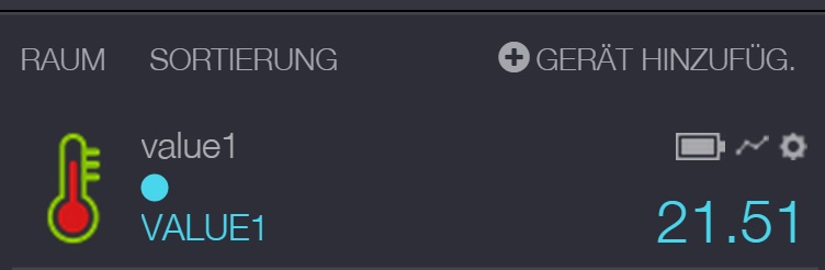

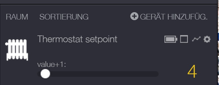

I have a Devolo thermostat (Danfoss OEM) connected to the Zipabox.

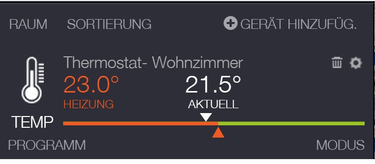

Now it shows me the set temperature and the measured temperature
but I can not control with the Zipabox the thermostat.

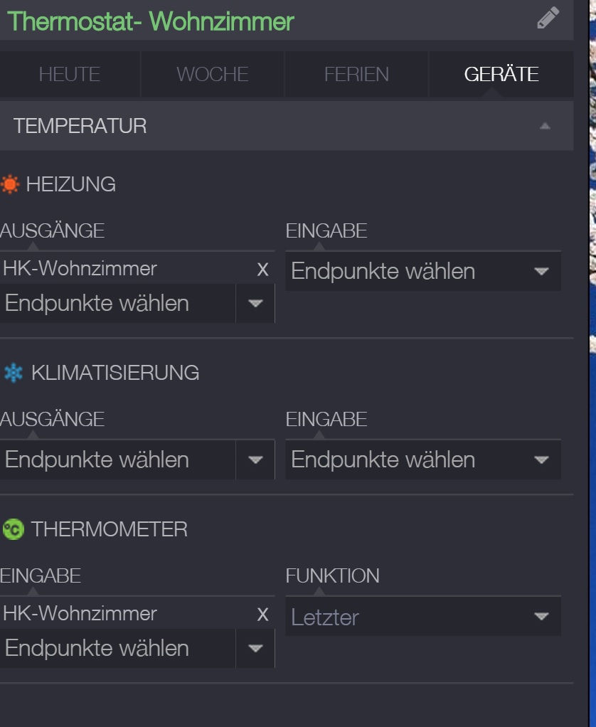

I have a virtual thermostat
Heating output = Devolo Thermostat
Temperature input = Devolo Thermostat
what settings I need,that this to work with the virtual thermostat und in the rule Rule Creator?

Devolo thermostat (Danfoss OEM) are compatible with Zipato and they should work. You should use a Danfoss as a heating output but use some kind of a Temperature sensor (or alternately a Virtual thermometer) as a Thermometer (Temperature input) you can't use Danfoss for this purpose.
If you still have troubles making it work please contact us on support.zipato.com and we will look into what is causing the issue.
