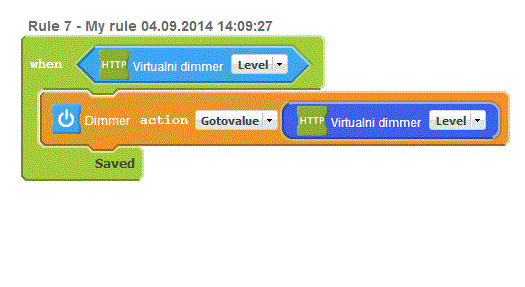

yes it is possible using a "Virtual level control" in Rules Creator. First you have to add Virtual level meter via add new device wizard. I have attached a screen shot of an example with only one dimmer (you can include more).
