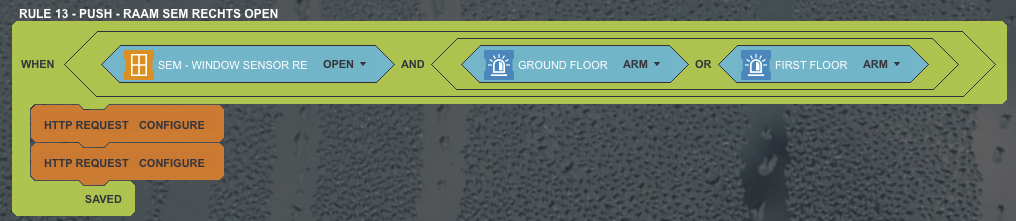

An email you already get if you configured that in your "Alarm", not that it's a good reading though.
You can just change your rules by adding a condition When Door Open and Alarm is Armed send message. This way you only send a message when your system is armed
Think a better option would be to use something like push over to send a message unless you want to have a sound on each mail that arrives....
I still dont get why one would not use the Security functionality off the box, because of the "illwritten" emails? In my experience the alarm functionality is more stable then "rules". I would still recommend you to create a virtual partition through the Security tab.
