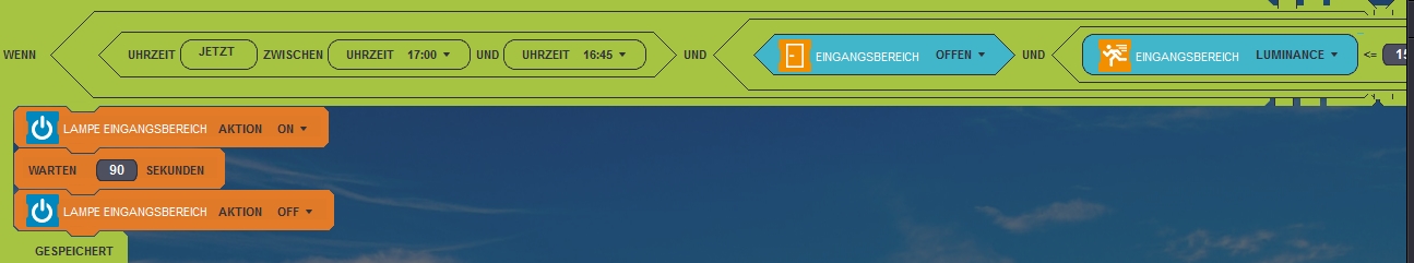

may somebody here can help me out....i created rule below for activating entry light during specific time frame as well lux level.
This rule is working so far, but instead of switching OFF the light after specific time this should stay at ON status during the motion sensor in the same area recognize any movement.
After a delay time (cancel delay or extra 5-10 seconds via puzzle) as well no movement the light should go OFF.
I hope someone can create this rule, i didn't get it.
Thank You for your support

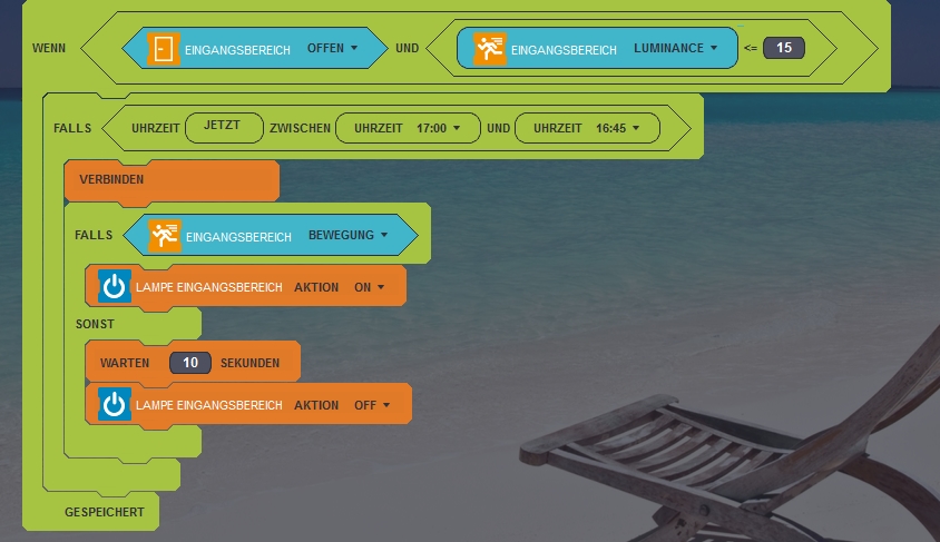

Hello Lars,
thank you for posting the link.
I tried attached rule without any success...something seems to be not correct. So the light should go ON when openening the door until there is movement. After waiting-puzzle the light should then go OFF when there is no movement at all.
Thanks.

Does anybody have an idea how to modify my attached rule to get it work like mentioned?
Thank you very much.

Can you change to english on the pic please. I will have a look!
Hello, thank you very much.
How can i switch to english inside the webapp, i cannot find language selection or similar.

At the top!

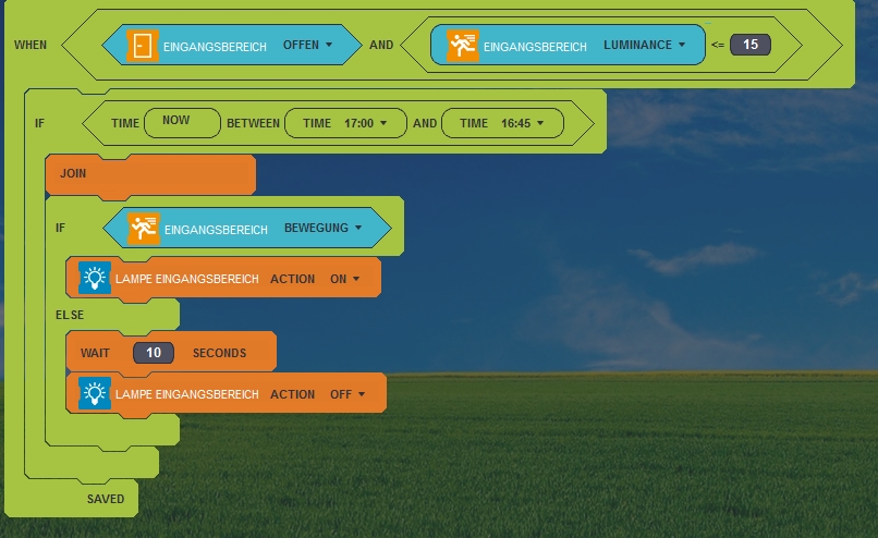

Please check file attached.
Thank you
Thank you

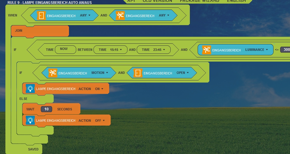

I have created a similar rul but with my devices, could you try it, of course you have to change time to your country: in Sweden 12:00 to 13:00 or something like that!
Maybe someone see the error right away but for me it is trial and error.
But first of al change time to 16:45 and 17:00 not the other way around!

Try making 2 rules and skip the time and luminous valu, and just get the motion to work and the door sensor to work. The problem is that I can't figure out how to only make the door work. Because at the moment any change of state of the door sensor wil trigger the rule, witch will cause the light to turn off because the sensor change to closed.

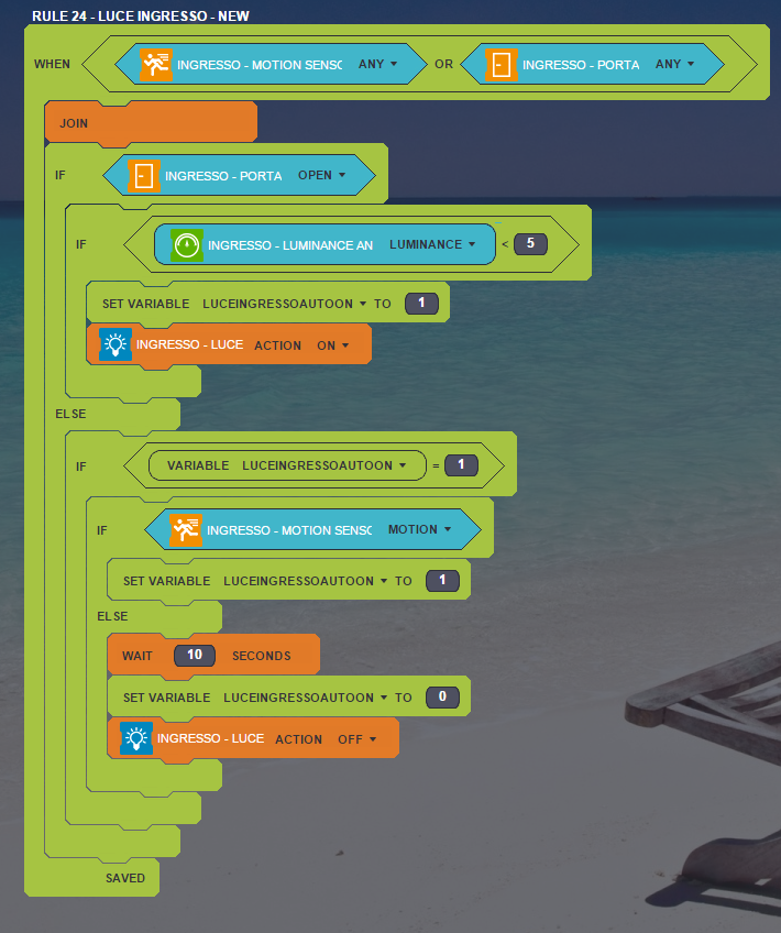

Hi Dirk, I use attached rule to do something similar to what you want to do.
You can add additional time frame check in AND with LUX check.
Let me know if it works.
Hi Carlo,
i did an update of your rule with time-puzzle. As my quick-check tells me this is currently working fine :)
Thank you for your help. I will test further and will let you know any issues.
