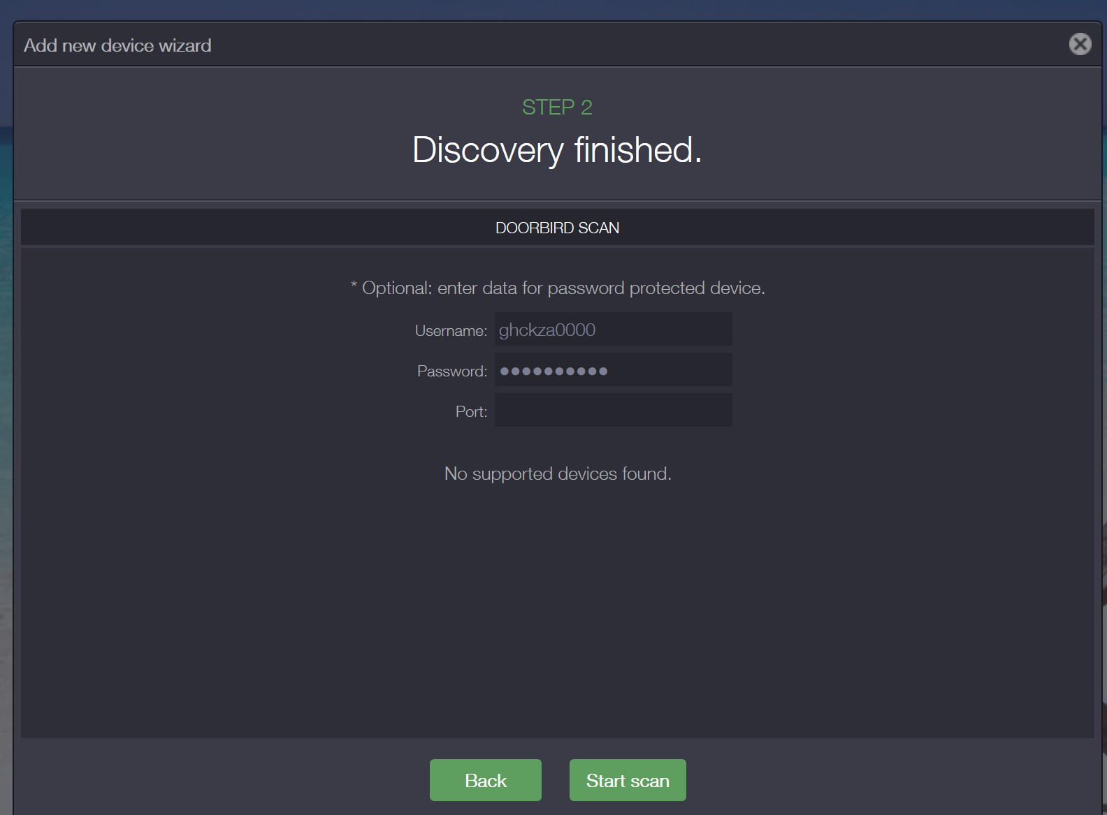

Hi, i can not add Doorbird D101s.

Is the zipato on the same network? I had no problems adding the dooebird
yes it is. I have no problem using it with app too. What number have you passed in "port" column ?
I have left the port on discovery empty. When I go to the settings, I can see that the port is populated at value 80. Also, the camera settings needs to be completed as upon opening the camera settings the user name and password will need adding.
No nothing, i tried to left port blank and set it to 80 too, but no change at all. I'm goint to open a ticket
bugger
