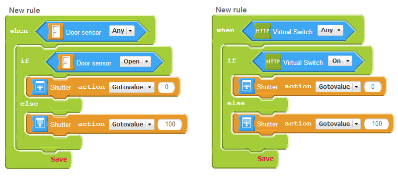

If i've understood you correctly, you can try creating these rules (view the attachment).
So your roll shutter will go to 100% when your door is closed (virtual switch turned off) and to 0 % when your door is opened (virtual switch turned on).
Don't forget to click Save and synchronize new rules.
