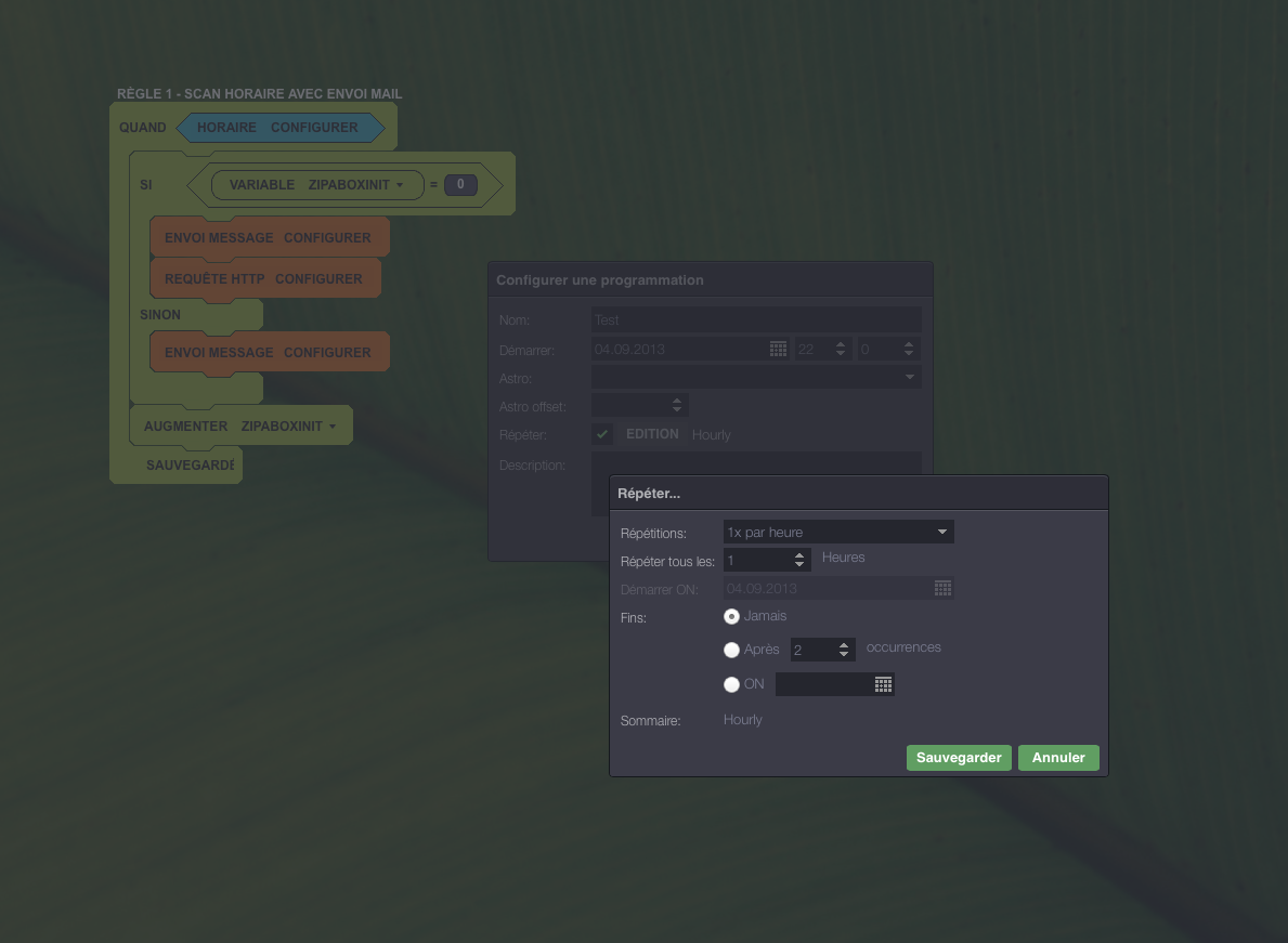

I have a rule that sends me email every hour from the scheduler. This works perfectly for over a year.
Since April 7, 2015 8:00 without touching anything,emails are send twice. Looking at the plain text of the email received by gmail , they are sent to a second interval.

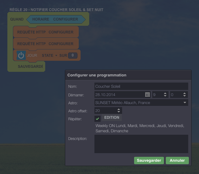

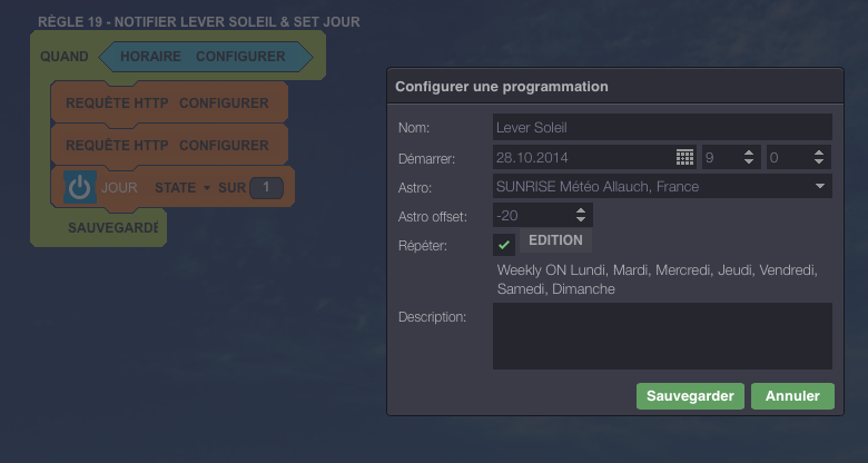

I also note that I have two old rules that use the scheduler which double the HTTP request to pushingbox
I done many tests adding (Join, Stop, Timer, Counter ..) The problem is not solved.
But I see (after each modification) that for the first trigger, the rule is no duplicate, for the subsequent there are duplicates.
Snapshot rules
Snapshot rules
