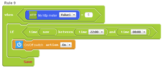

If you want http request to do something only between 18 and 22,
there is a simple way to do it with time between and a overly complicated way to do it with 2 schedules and a variable.
Simple way would be something like:

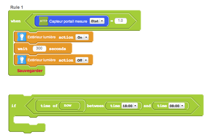

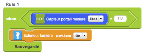

I tried between 18h and 8h (now 20h) and with the condition "if time ... between ... and ..." does not work, whereas in removing the rule works again.
Tested at 20h:
Rule that does not work: capture 1
Rule works : capture 2
Any idea ...?
Thanks !

That's my bad.
The firmware that you have doesn't implicitly convert from datetime to time in 'time between' command, but you have to explicitly convert it with to 'time of' command. That will not be necessary with next firmware.
Please try

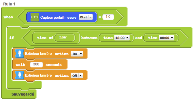

This time the problem is reversed, the action runs all the time, regardless of the time interval.
Indeed, it is 12am and the action should not be executed, or my lights come on ...

There was a bug in the time range puzzle. High and low were swapped. Fixed in new version.

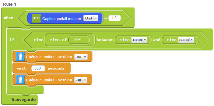

despite the new version 0.9.9.6, the problem with time range puzzle is still present ...
Your example "TimeBetweenRule.png" is not working for me withe the latest version. Can you confirm me thait this rule is working now ?
