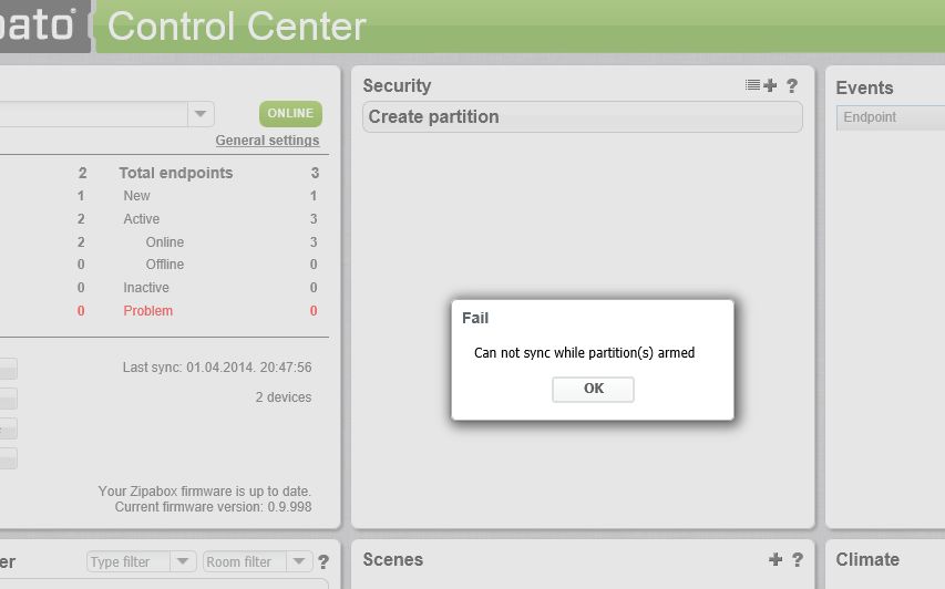

error "Can not sync while partition (s) armed"
When I try to synch. my zipabox I always get the message "Can not sync while partition (s) armed". This started after removing a partition in the security app. How can I fix this?

adding a new partition and then disarm it again doesn't work either.

Same problem , Shame on me i deleted a partition while it was armed...

Yes they need to access your Zipabox to fix it. Open a ticket and someone will fix it. They are usually pretty fast to do it.

So, maybe it's a good idea for Zipato to ensure that an armed partition can not be deleted? I am currently having the same problem (waiting for Zipato support to fix it).
Until then I can not do anything else; syncing does not work (so no rule changes can be made), adding devices doesn't work, etc.

Right, Zipato fixed it within 1 hour at my place.
nevertheless it should not happen. Zipato should not permit actions that are leading to this state either thru the interface or the API.

In fact it is not an error message - more a warning.
When you have set your alarm on you cannot - for whatsoever reason- use synchronisation.
The real errror that is occuring is if for instance you are forcing to a new release update thru API, you systeml remains locked and you need Zipato to recreate the partition.
Try to disarm you alarm, sync should work again.
