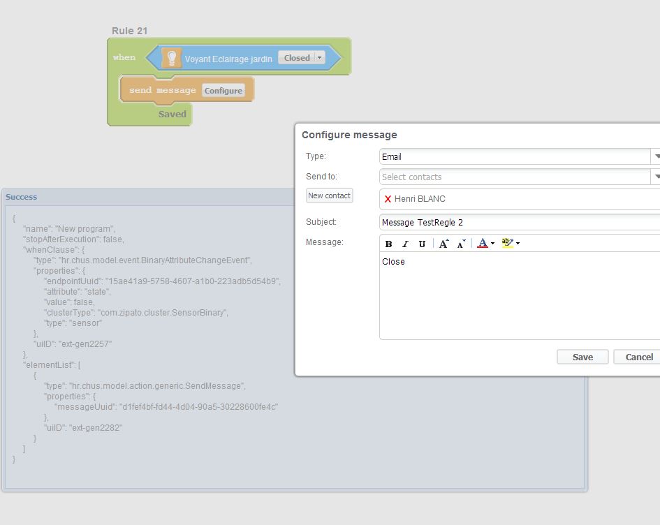

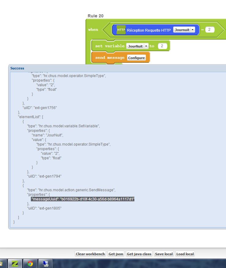

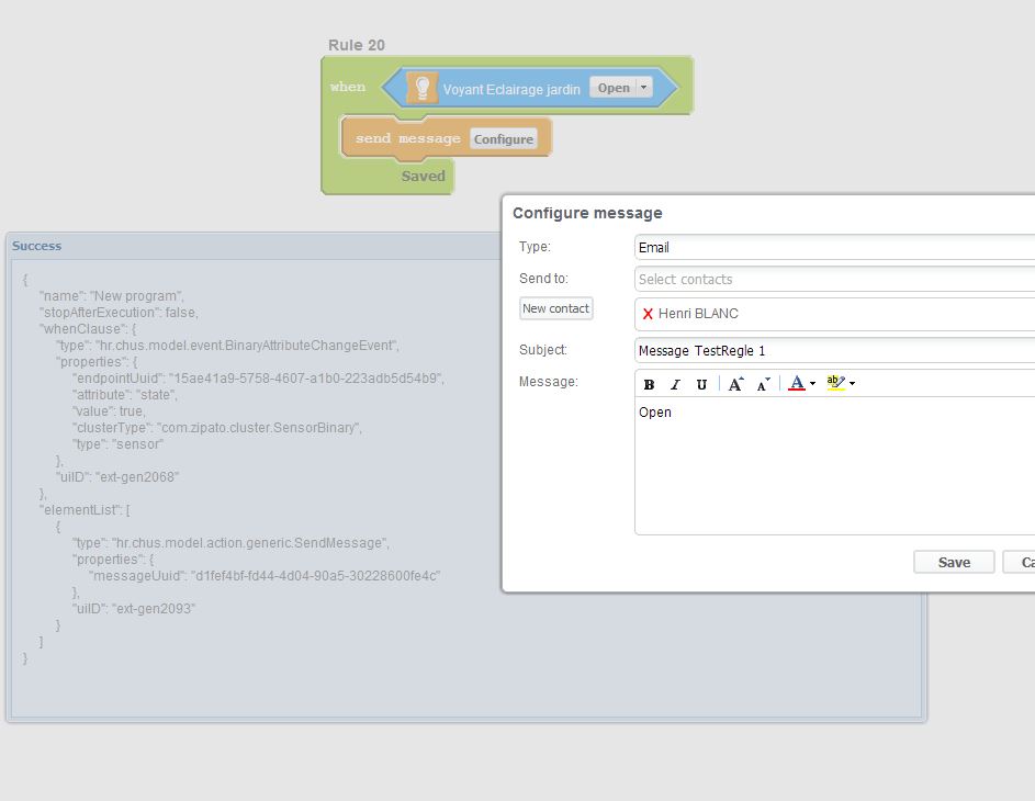

I look at the generated Json and surprise for different rules, the messageUid is the same . SO everything is explained.
What is confusing is that if you look at the two rules by edit the settings of the email they are different.

Je regarde le code généré (Get Json ) et là surprise pour les deux règles différentes, le messageUid est le même. ET donc tout s'explique.
Ce qui est déroutant c'est que si on examine les deux règles par edit les parametres du mail ils sont différents.

@Kristian in the editing rule you entry CTRL+SHIFT+1 and then you obtain in the bottom of the screen a line for see code
For the message Uid for mail i'm sure that the pointer is the same in the original rule ans the new rule created by this way.

A rule is duplicated with a message, the message is the same in both rules, and if we change, it will change for both. Ok with that.
But what is puzzling and confusing and misdiagnosis is that after time, if the rules are edited on rule editor, the original rule still displays the old message.
You understand what I mean (sorry for my english I'm french)
Look at my attachments R1 is the initial rule, R2 is the rules after the duplication and modification. Both rules are published after the modification of the second.
Both rules have turned, and sent the message of rule 2, which is normal, but this is not what we understand by looking at the edition on the screen.
