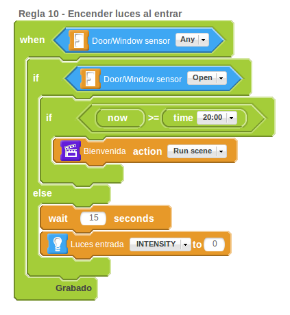

I have this rule (attached file). The conditional time "if [now >= time (20:00)]" try to switch on the lights when the door opens later than 20:00, but the light turn on allways!!! at 6:00, at 12:00, at 14:00...
Is something wrong in the rule?

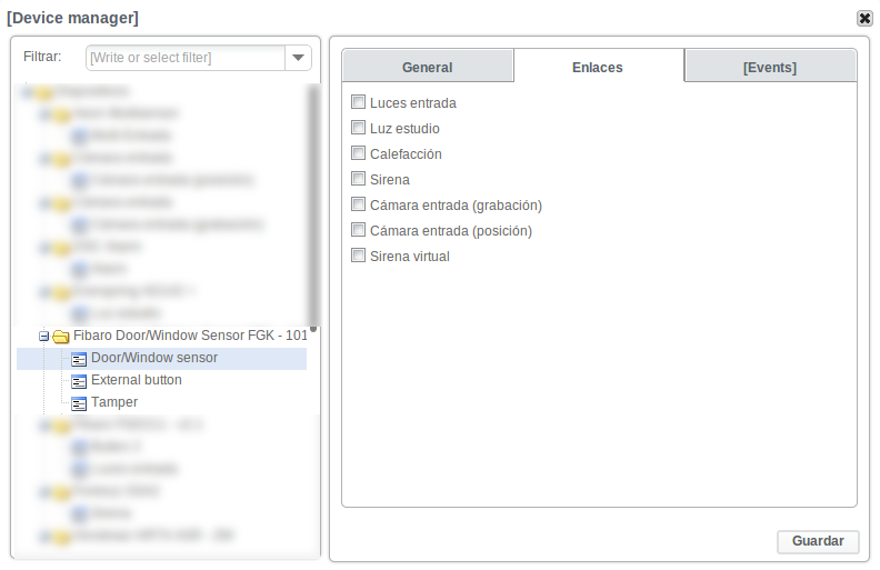

Still the issue.... I think this should be a bug, I don't understand where is the problem... The device is not binded with any other device or light, and the rule I think is correct...

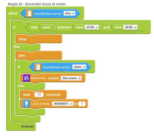

It's not a bug and solution is pretty simple. You should use 'time between' puzzle (Variable group).
Your rule should look like this:

Still not working.... Are you sure it's not a bug? I only want that lights switch on when the door opens between 20:00 and 7:00 (in the night), but it switch on the light allways.

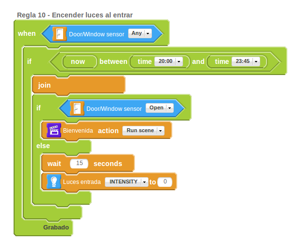

Your is breaking our compiler and your new rule was never executed.
Try to create rule like this:

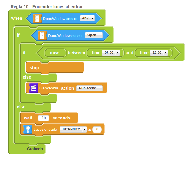

I've deleted the previous rule and created a new one. Now it looks like this:
Now the lights never are turned on when the door is open. I've being trying all the day (at 10:00, at 20:30...)... nothing occurs.

It's solved!!! I have deleted the rule and created again. The problem was in "Where" condition, It never fired (I don't know why). Making the rule again solved the problem.
Thanks everybody for you help.
