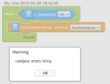

Error while saving my rule with action Startchangeup
I try to create a rule and i've got error when i save the rule, after she appear "invalid" in rule list.
"rule2java: empty string"
have you identify this problem ?

The problem is that I use a fibaro roller shutter motor with electronic stop. Fibaro module does not handle this type of engine it because it is not possible to manage INTERMEDIATE positions. So, I would level it with the rule engine.
I can not use the gotovalue. . .
What is then the Startchangeup?

Now you can use actions 'startChangeDown', 'startChangeUp', 'stopChange' with your device.
Simple rule would look like this:
