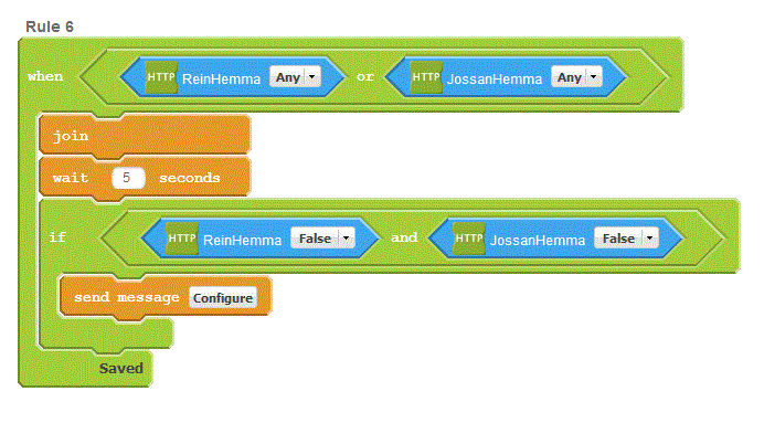

I want to send an email when two virtual switches is false (when both me and my wife has left the building)
It worked before the 0.9.73 update but now I get the mail when just I leave home.
in the attached file, the second switch "JossanHemma" is TRUE but when I switch the first switch "ReinHemma" to false the email is sent.

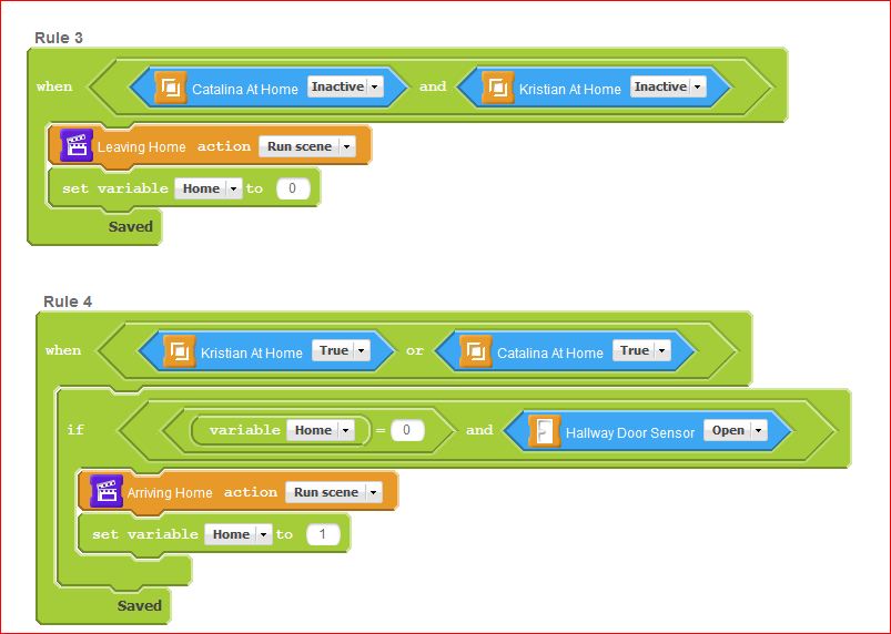

I see that you are working with the same thing as i... This is how i did it
hmm.. it seems to work after I added a "refresh all" after the sleep.
@ZipatoTeam
What does actually the "refresh all" do?
now the error occurred again even when I had the "refresh all variables" after the sleep..
