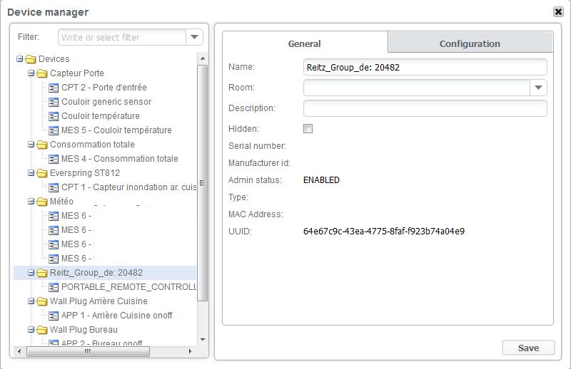

When I click on Associate Button on the Everlux switch, Zipabox recognize it, but the association doesn't work, I have this message :
Device found.Joining device please wait.
Join not successful.Then, when I refresh the Zipabox interface and I go on the device manager, I see a new line named : "Reitz_Group_de: 20482" (see attached file), but I seems not to be the correct device. I don't associated this device with a Fibaro Wall Plug in the device manager for example.
