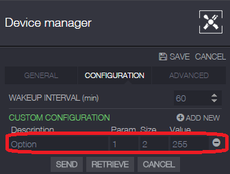

Zipato support answer and steps how to resolve:Go to configuration tab of the motion sensor and then enter the following and see the attached picture for reference:
Option | 1 | 2 | 255
Then "Save" and "Sync", after that refresh the page and go again to the configuration tab of the device. Then check that the sensor
is reporting back the value by clicking the "Retrieve" button, if it returns the value of 255 it is all set to work properly.
