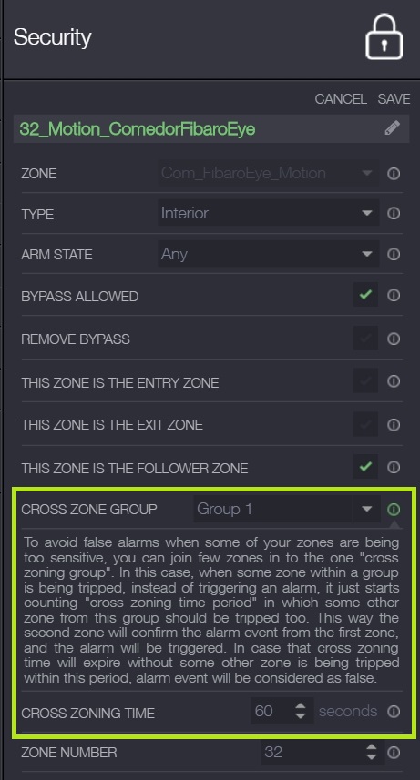

Yes it is a very good idea. Hey, if I may ask, is this triggering your home security system? after having this issue a few times I read the manual completely and I read a note where it says that air flows sometimes can be detected as motion. I was happy with the sensitivity so what I did is to configure the zones within the security alarm as "Group 1" which is basically all my motion sensors so, if only one sensor detects motion it won't trigger the alarm. If more than one detect motion within a configurable window of time, then the alarm is triggered. If that is your case too you might want to give it a shot.

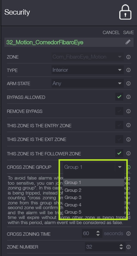

If you go to the configuration of the zones in your security alarm (little gear icon on the right of the name of the zone), inside the configuration menu you can see the "CROSS ZONE GROUP" and "CROSS ZONING TIME" if you click in the little "i" icon you will get a brief description of what are this basically;
CROSS ZONE GROUP - This is the group you want that particular zone (sensor), as you stated, group 1 can be your "upstairs" group 2 can be "downstairs" (no, you cannot change the name of the groups).
CROSS ZONING TIME - This is the time you want that passes between one sensor "Tripping" and the second sensor "tripping" creating a security alarm TRIP. I.E. lets say you set this time for sensor "A" and "B", sensor A detects motion and this timer starts counting, if at second 15 sensor B detects motion then the alarm gets tripped. In the other hand if sensor B gets tripped after second 31, then the alarm does not get tripped but another 30 second timer starts timing for another motion. I hope I'm being clear. Regards.
