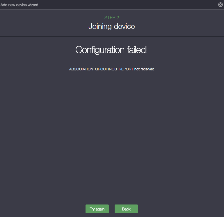

I have a problem with the Zipabox, not to include a Zwave module. After adding module, choice Zwave it says "exclusion failed" before they can put the module in exclusion mode. If I force to arrive fashion inclusion, it is noted "configuration failed".
- I have already included similar modules without problems
- Firmware updated without change
- Restart of the Box ineffective
Thank you for your help.
Philippe

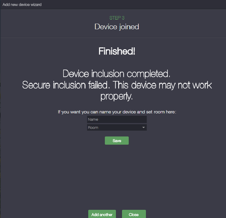

I got already 2 tickets opened. explaining the same issue for my fibaro motion sensors.
after some reboots exclusion worked. but got stuck at inclusion.
or strange messages like attachment

Dear All,
Our team has made changes in device descriptor and resolve this issue. To implement new descriptor please readd your Fibaro Motion sensor.
Feel free to test it out for yourselves and leave us some feedback here.
Pero Zovkic
Dear All,
Pero Zovkic
