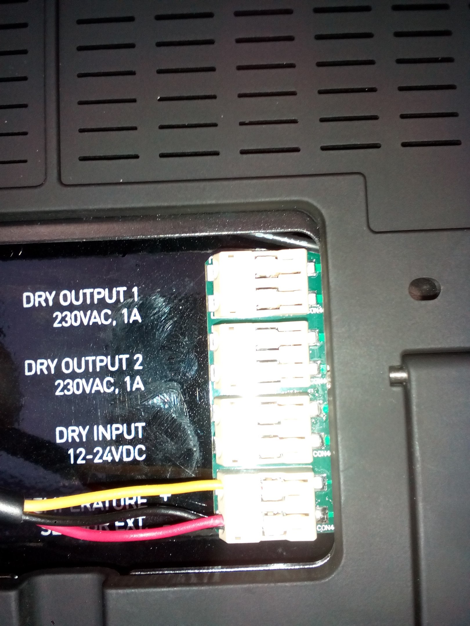

I have zipatile. I tried to connect an external temperature sensor ds18b20. Has connected, as on schemes. But the controller does not see the sensor. Did I do it right?

I connected as on the scheme. How will the sensor be displayed in the interface?
You might need to show the endpoint in the UI. Go to the IP-internal and search for the device. Open settings and mark "Show device"
The sensor is working=) Thank you!
