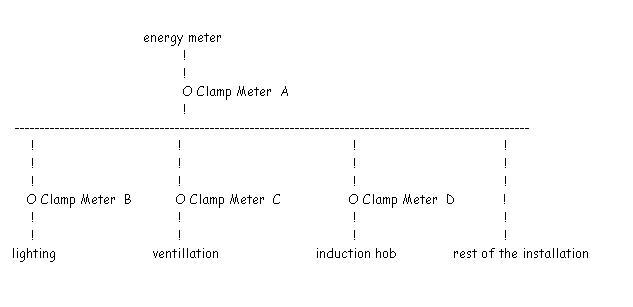

I connected the energy unit for several weeks. conclusions measures:
energy meter
O Clamp Meter A
O Clamp Meter B O Clamp Meter C O Clamp Meter D !
lighting ventillation induction hob rest of the installation
My energy meter measure 99 kWh
Clamp meter A : 77 kWh & 112 kVA --> an error of more than 20%
-when my induction hob does not work :
Clamp Meter D measures : 0,15 A & - 2,35 W (negative power) & 35,7 VA
Clamp Meter A measures : 0,75 A & 110 W & 174 VA
- when my induction hob works
Clamp Meter D measures : 13,4 A & 3 052 W & 3 084 VA
Clamp Meter A measures : 12,6 A & 2 802 W & 2 914 VA
The Clamp Meter A is less than the Clamp Meter D --> impossible
Negative active power --> impossible
The measures is not reliable !!! what do you do?
