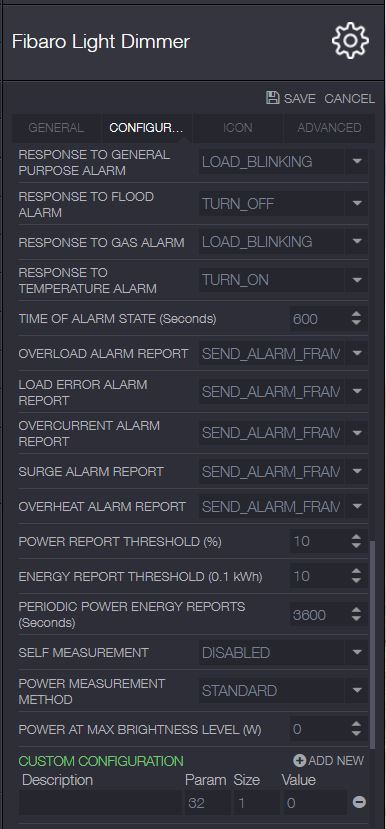

Read paramater 32. If this is set to 1 dimming is not possible.
Write 0 to this parameter.
32. On/Off mode
This mode is necessary while connecting non-dimmable light sources. Setting this parameter to 1 automatically ignores brightening/ dimming time settings. Forced auto-calibration will set this parameter’s value to 2. Available settings: 0 - on/off mode disabled (dimming is possible) 1 - on/off mode enabled (dimming is not possible) 2 - mode selected automatically
