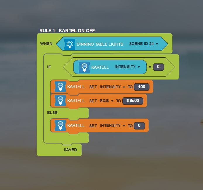

Ι have solved the problem by creating a rule and thus using the controller to perform a specific action when pressing S2 switch.
I searched and found the configuration values of the fibaro Dimmer and then created a rule for the specific actuator using the config value used to address to the S2 switch.
How did you get the scene to be accessible on the device in the rule creator? In that dropdown, I only see level, cumulative consumption and current consumption - no option for scenes.
I also see the image posted in this thread which shows a 'button 2 pressed' event in the rule creator, which also isn't available to me (this is on a switch not a dimmer, but I'd expect similar functionality to be available for the second switch).
