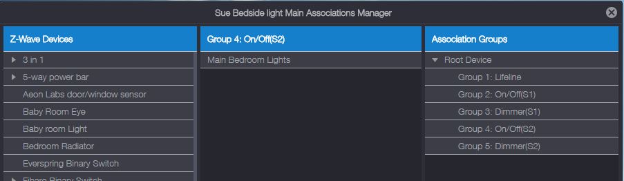

Hello Sam,
I am having some issues with the fibaro 212 dimmer. I cannot see the association groups except number 3 like u did.
Did u manage to solve the problem and use the 212 S2 switch with your box?
Yes I got it configured correctly using the "Manage Associations" for the parent device. on the associations manager screen - in the right hand side panel you should see root device, expand it out and then you should see groups 1-3 for the older dimmers and for the newer Dimmer 2 (212) you'll see Group 1-5 listed under the root device. I configured associations for Group 4 and 5 to the same device (Main Bedroom Lights). See screenshot attached. Don't be tempted to use the bindings - option. I cleared all that out and just used the associations manager.
Hope this helps.
