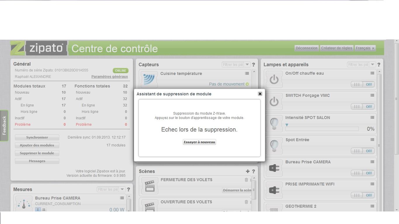

I have a problem with FIBARO FGK 101 ...for several days the module is spent in offline on Zipato Dashboard :(→ Impossible to exclude it from my configuration (image1)

Test exclusion → NOK (image 1)
