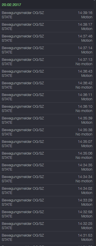

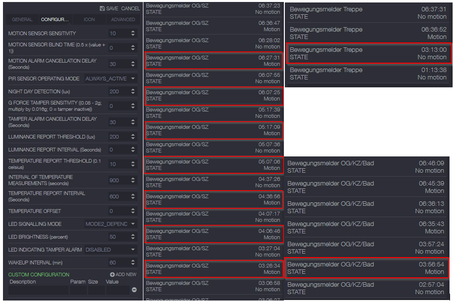

I am using 3 Fibaro motion sensors to switch lights. Since a couple weeks, the lights are turning automatically on during night time. I have no pets or kids to trigger a motion sensor. I went to the event log and found out, that all 3 sensors got motion events. What is wrong in this case? See attached config and events. Could this be related to temperature/luminance?

In my case, the "ghost" motion signals seem connected with the wake-up intervals of the sensors. A few seconds after they have woken up and reported "no motion" they report "motion". Fibaro support was most unhelpful. In one instance, it seemed tonhave helped to set the sensitivity from the defaul 8 to 10. I will try the same with the other one that is acting up currently (just have to get the ladder for that ...) and see if that works as well.

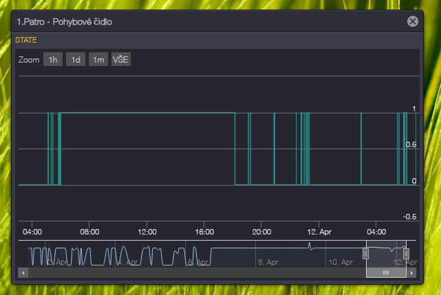

I have had the same problem with one of mine fibaro motion sensors
By changing the sensitivity the problem seems to go away.
Sometimes it get stuck on "motion", but is reverted to "no motion" when waked up.
This is what Fibaro wrote back to me after contactin support (but i still think it's the sensitivity):
I believe the problem is not directly connected with the sensitivity of the sensor, but lack of so called “blind time”.
Please set parameter 2 to value 15 (8 seconds of blind time) and 6 to value of 15 seconds.
This would extend the battery life and also reduce number of useless z-wave traffic as the sensor may keep on reporting on the time in case of a lot movement in a room.
This setting also is a good option in case Motion is to report movement and then turn ON/OFF some associated device (for example light).

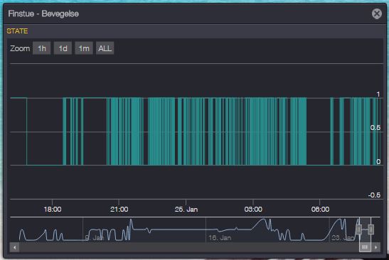

few off my fibaro sensors have started to act up aswell. (never have hade problems with them before and have not changed anything)
problem 1: i can see the reaction of moment from the detector, but status is not updated in zipabox
problem 2: zipato seams to miss the no moment message, so the device looks like its stuck in moment untill new moment is detected and next no moment is sent

Well, firstly upgrade to latest version. Mine is right now 1.2.22i. Also try doing a Network heal on these devices using the ZWNTUT topology update located in the Zwave network settings in Device manager.
You can also try to go to the root level setting of the problematic device and use the following 2 functions:
General settings - reapply device descriptors
Advanced - configure node

I have contacted support and adviced me to upgrade to the latest firmware and exclude/include the sensor once in the latest firmware. I did it for one of them and I noticed it did improve its performance, at least my alarm is not tripping every time I arm it AWAY. Try do the same and let us know if it worked.
