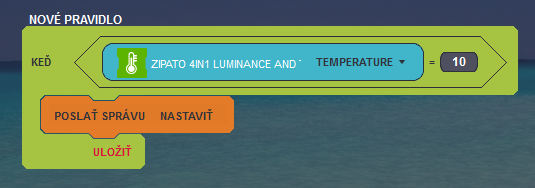

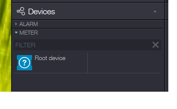

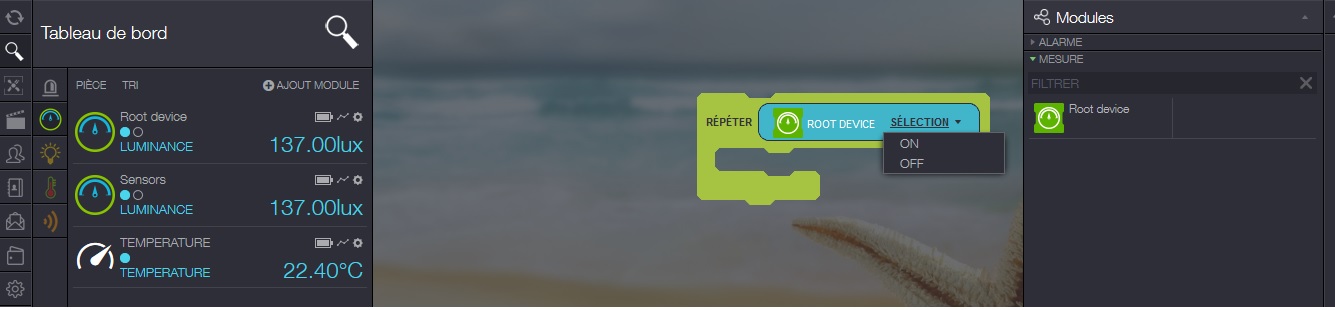

I connect my Fibaro Motion Sensor FGMS-001 (Z-Wave) with my Zipato. I can see all measures like temperature and luminance. I want to create a rule with the temperature. Exemple : to have a message when temperature is 10 degrees. I can't see the measure temperature in the rule creator like you can see in this image. And,Zipato mention that this sensor is supported. So, what is the problem ?

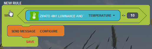

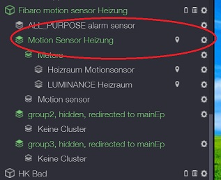

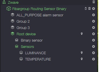

Hi, You cannot use root device in the rules. It does not work. You need to find the temperature subdevice and include that in the rule. Something like this attached. Fibaro is fully supported.

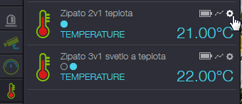

Thanks for your comments but like you can see in my picture, in my list of measures (module) I only see Root device, nothing else .... In my dashboard, I see the temperature sensor. So I can't choose anything else of root device ...

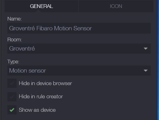

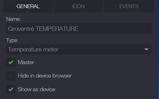

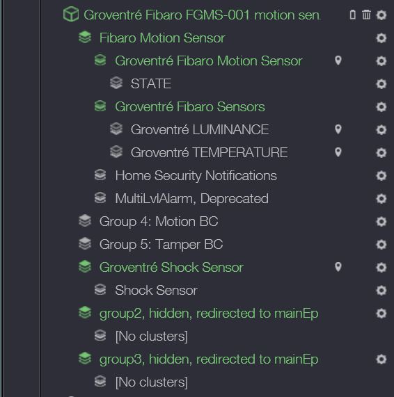

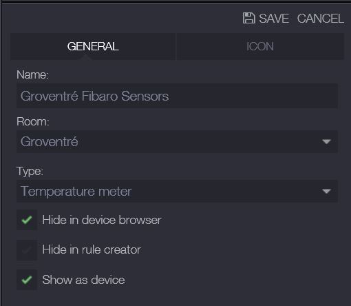

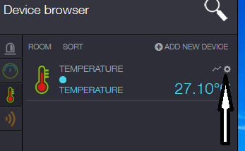

Hi Julie, open the setting for the actual temperature device and un-thick option "Hide in rule creator". if you have it already un-thicked, than do the opposite (thick). Sync, refresh. Then un-thick it, sync, refresh. Now it should be in rule creator. Sometimes it just stuck in the web interface.
I also attached the rule that should work. You are always starting with a "When" block nothing else (just saying as on your picture you have a repeat block). Every block starts with a "When" regardless of whatever you want to achieve. And last, you dont want to send you a message when temperature is 10 degrees, because you will not get a message if the temperature is 10.1 or 9,9 degrees. You rather want a equals or lower (like in the attached rule)

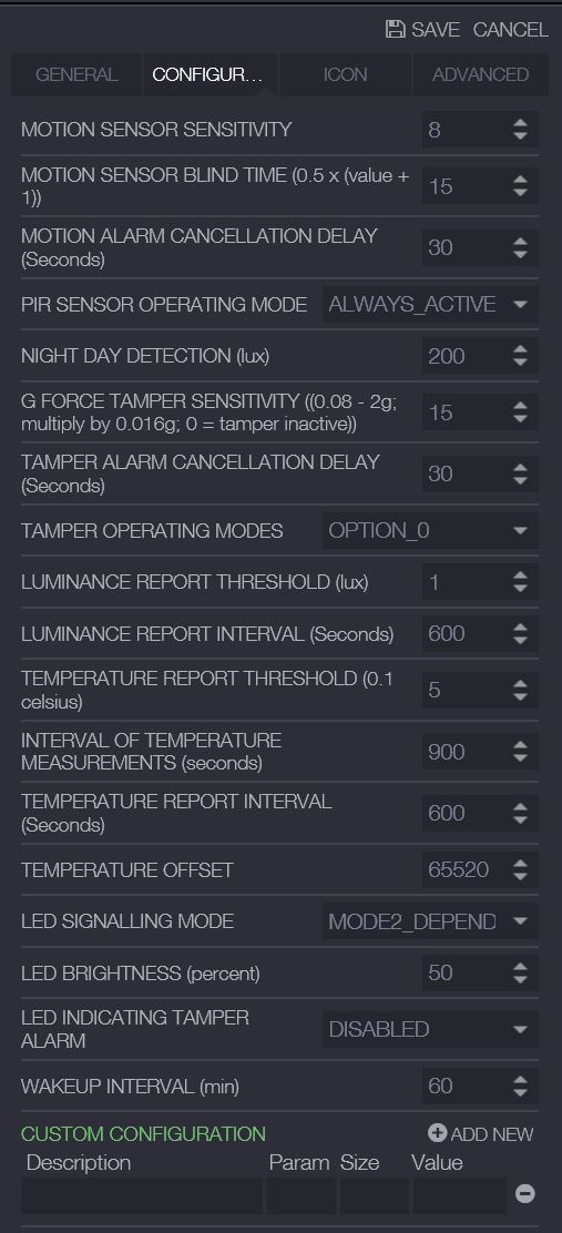

When I open the configuration page (sensor 1.png) , I don't see <Hide in rule creator> (hide.png). So, I did many test with check and uncheck the box option and I never see the Temperature in rule creator. Also, I check/uncheck the <Hide ini rule creator> box for root device and I don't see any change in the device list, Root device is always showed. My firmware is 0.0.999.8 and I don't upgrade tp pro version. Are you sure than this multi-sensor is supported ?

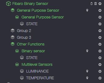

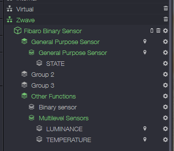

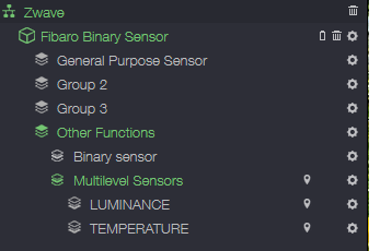

I updated my box with the newest version. I deleted and added the device 2 times ... it didn't work ... I remark that the device is Fibaro Binary Sensor in my list but I have a Fibaro Zwave Multi Sensor For Motion, Temperature, Light (FGMS-001) in my hands ... is it normal ?

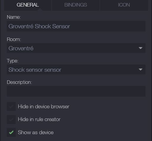

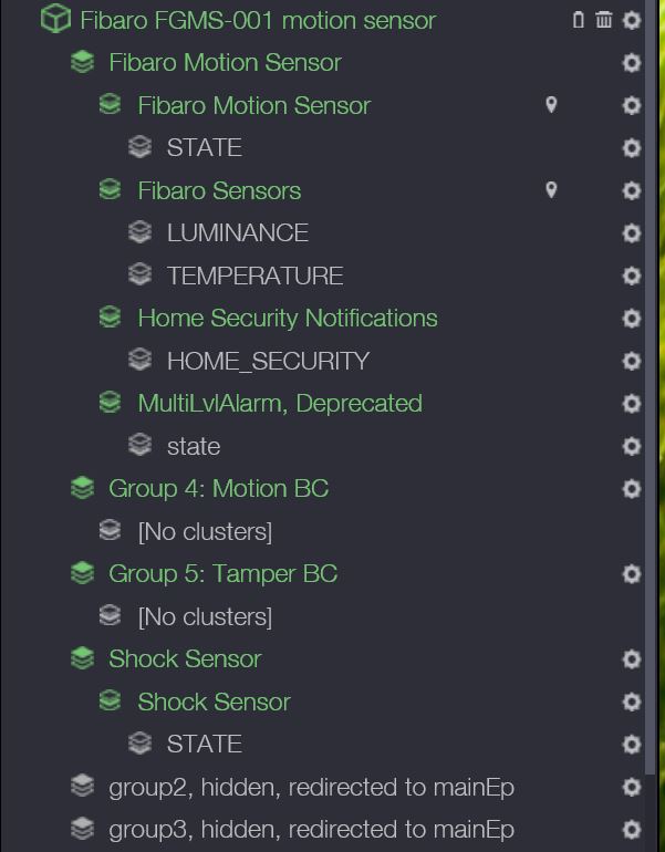

I just included one and this what I received.
Have you reset the sensor before you added it?

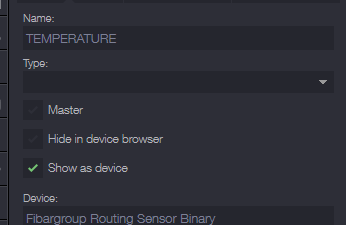

I too have exactly the same problem FGMS-01 is reporting as a binary sensor. I am using firmware 1.0.10
