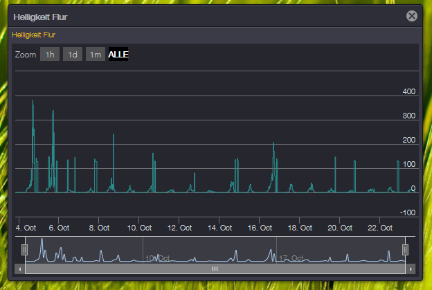

Same problem here since I´ve bought the Sensor. The value for luminance is always ways to low. Only in the summertime I sometimes got values of a couple of thousands. But normaly the floor, which is not that dark at all, seems to be pitch dark.
