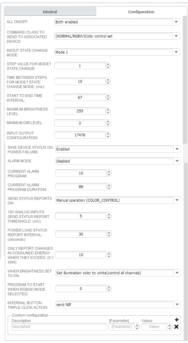

I link a RGBW module on my zipabox, but inputs are not detected.
Is my configuration in attachement correct ?
More details: https://community.zipato.com/responses/rgbw-configuration-to-have-inputs
