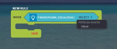

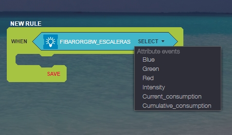

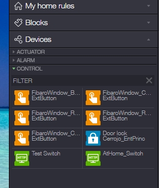

I will look for this on my set up, need to look on the manual to see how they handle the groups for this device, but highly doubt that the device shows "triple click" or even "button press" in the rule creator. The only one I have seen is for the fibaro door/window sensor. I have both and never seen that option for RBGW. See attached.

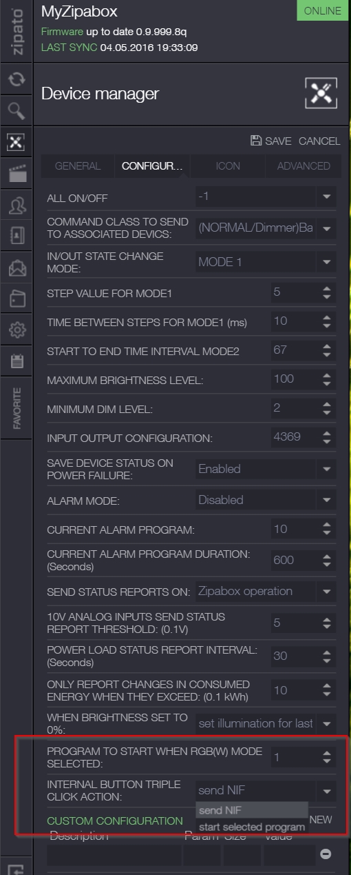

I think I found a setting that might do the trick. I cannot find how to set up a "program" to run while alarmed or triple click.

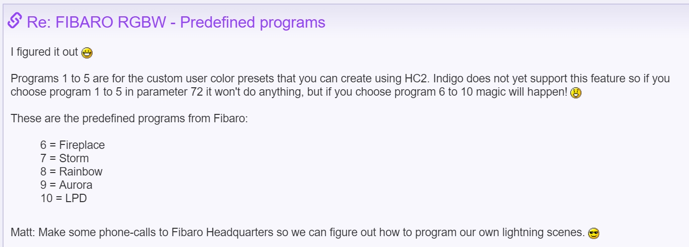

Found this on and Indigo Forum, looks like also Zipato does not support the programing of custom programs, we could try with the preset ones. Unfortunately I cannot test right now, I'm on a work field trip.

I also was able to actiavte the programs from 6 to 10 using "SEND" command to parameter 72 in device's configuration. I think the triple click refers to a triple click on the B-Button (physical button on device used also to "wake it up"). We should be able to use rule creator to trigger and configure these programs... maybe open a request?

Nope, you have to change the settings on the device so when you triple click the B-button, instead of sending NIF to the main controller it would start the selected program, not convenient at all since this device is always hidden.

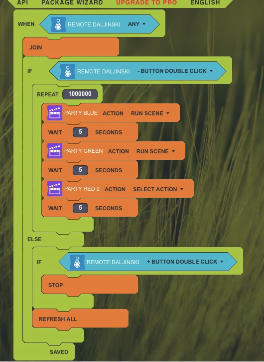

instead of triggering program you can make your own program and control it.
Well, you can but it is complicated and not user friendly.
