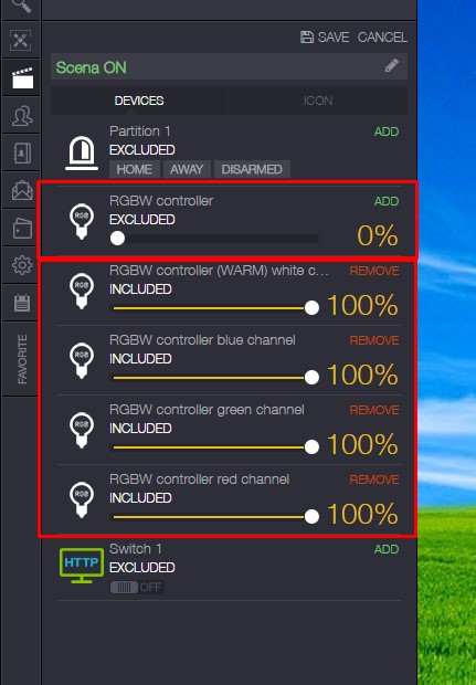

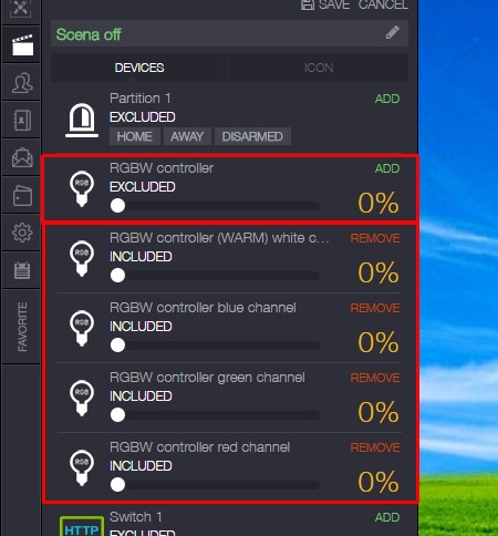

If you are trying to use the main RGBW controller in the scene is not going to work. I opened a ticket a while a go and Zipato support mentioned the color channels (RGBW) need to be added individualy and use these to configure color of the RGBW, otherwise it will not work. See attached examples they gave me, for collors you need to change each channel to the desired setting.

ahh... well.. that will work for me :)..
