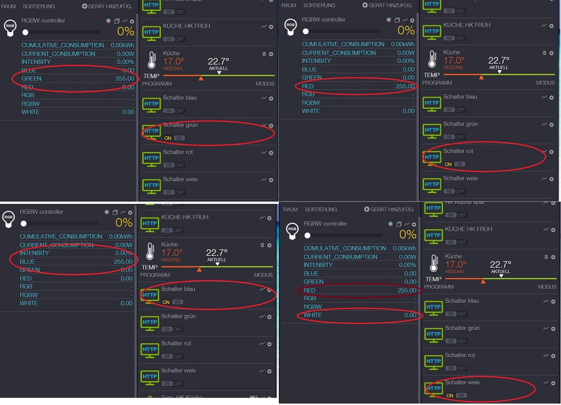

I have a Fibaro RGBW module and want so switch 4 relays.

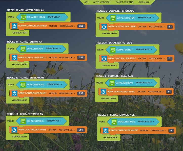

I have created a few rules created to switch the outputs.
Red, blue and green work but white switched other color.
What settings do I need to make it work?

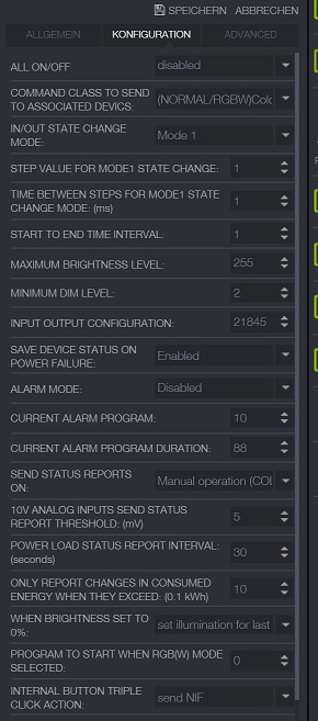

Hey, what is your setting in parameter 14?
Settings in parameter 14 =
Settings in parameter 14 = 21845

I would like to use the Fibaro RGBW Module only with outputs. But I doesn´t work.
I use as Input/Output configuration 9999 (HEX) and also 39321 (DEC) (I also tried many others).
I also can not set the max brightness to 255. It always chages the value to -1 after saving. The same thing when I try to save the DEC value in the Input/Output configuration.
Any suggestions?
(I´m currently running 09.999.8q)
Hi Christoph. It seems like the -1 is an errratic interpetation of the numbers in the Zipato new app. If you use the old app ( https://my.zipato.com/zipato-web/Dashboard# ) you can actually store and see the correct the values.
However there seems to be bugs on the fibaro itself not acting on values above hex 8888 - so until this point I have also been unsuccesfull getting the thing to Work. Best option is to create som virtual swithces setting the values of e.g. rgb red to 255 for on and 0 for off - this Works with most ~12v dc devices/appliances.
