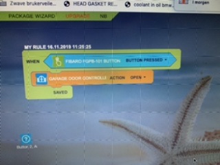

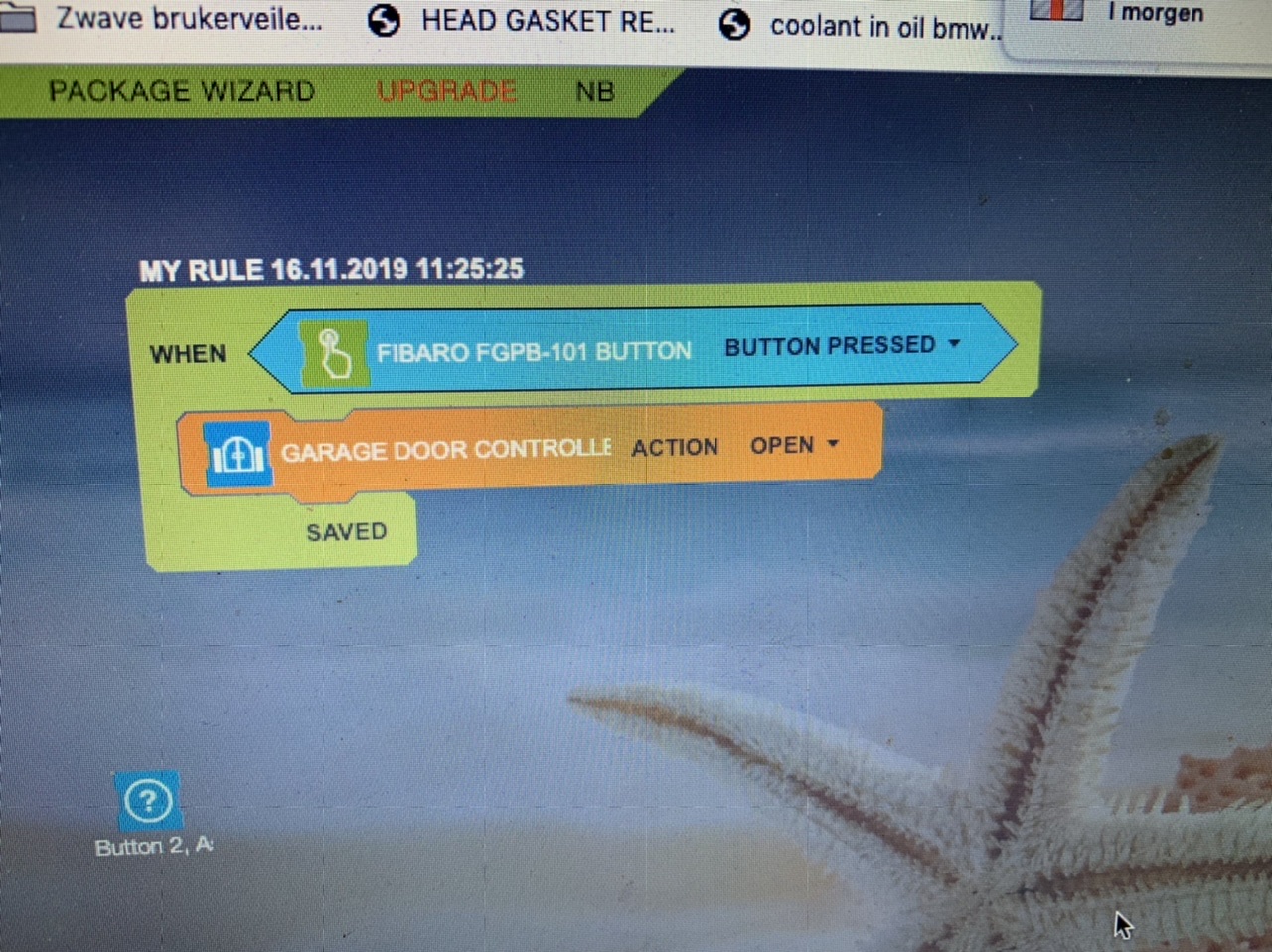

I am trying to get my new «button» to do a simple thing like open and close me garagedoor (Zwave)As I understand i have to make a rule in the rulecreator. I am trying but nothing is happening... any advice? I guess the rule will be simple?
Please show us a screenshot of the rule.
Here is the rule.... i guess I am doing something wrong because I cant get the button to do anything...not just open the garagedoor... I dont have to do anything else than creating rules after I have added the button to the zipatil/zipabox?
The rule is ok. I think the problem is the fibaro button. Please try it with an another device.
